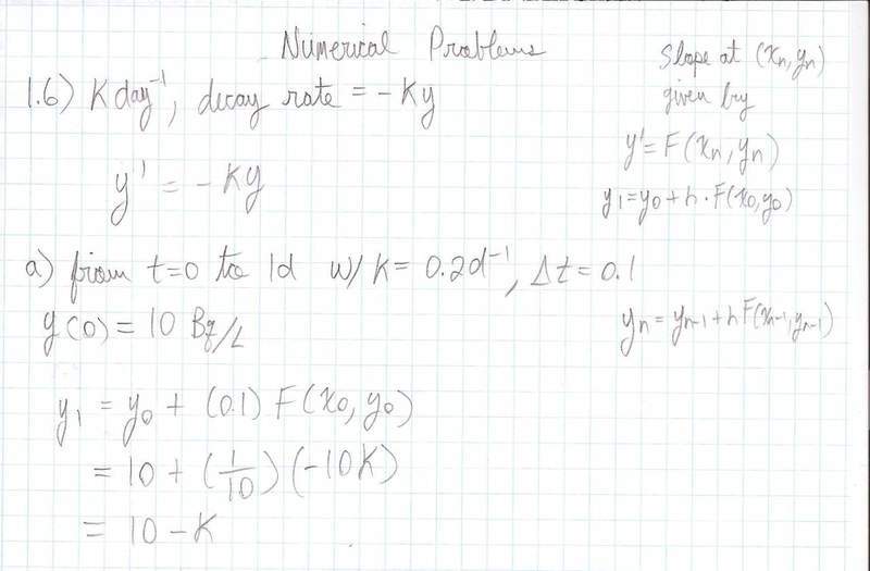

See figure attached for problem statement.
Here's as far as I got,
The part that confuses me is the range we should solve this equation. It says,
[tex]\text{from } t=0 \text{ to } 1d[/tex]
I put the [tex]^{-1}[/tex] in there with pencil because I thought it was a typo. Is it?
If I can figure out where to stop I really just have to keep repeating the formula,
[tex]y_{n} = y_{n-1} + \Delta t F(x_{n-1}, y_{n-1})[/tex]
Right?
Thanks again!

Bump, still looking for some help.
No, t is time and it's units are days or d, not d-1.
Right?
Thanks again!
Yes, that is the correct approach. You stop once you have reached t = 1 day.

But how will I reach 1 day?
I have,
[tex]10-k[/tex] where k has units [tex]day^{-1}[/tex].
Can you explain please?
Well, if you're going to be careful about the units -- and it's a good thing if you are -- then you need to include the units correctly on all quantities. Note that Δt should really be 0.1d, not simply 0.1 as stated in the problem statement.
So you really have
y1 = y0 - k·y0·Δt
. . .= 10 Bq/L - (0.2 d-1)*(10 Bq/L)*(0.1 d)
. . .= 10 Bq/L - 0.2 Bq/L = 9.8 Bq/L
That is y1, so that is the concentration at 1·Δt or 0.1 days.
When you calculate yn, you will have the concentration after n·Δt or n·0.1 days.
