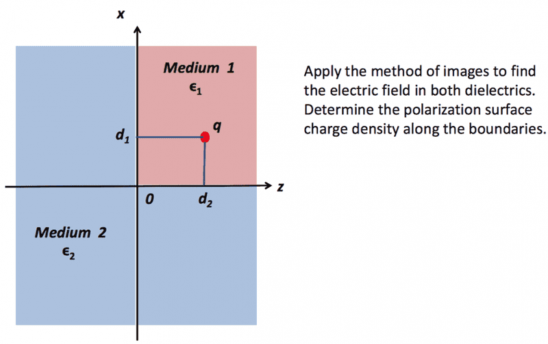

The question is attached.
I understand that the question would return to a typical conductor problem when ε2 >> ε1 so for the quadrant one, I placed image charges of q_1 at (d1 , 0 , -d2), -q1 at (-d1 , 0 , -d2) and another q1 at (-d1 , 0 , d2) with q1 = (ε1 - ε2)*q/(ε1 + ε2). When I applies the boundary conditions, I find that the image charges for quadrant two is q - q_1 at (d1 , 0 , d2), -q1 at (-d1 , 0 , -d2) and q1 at (-d1 , 0 , d2), for quadrant four is q - q_1 at (d1 , 0 , d2), -q1 at (-d1 , 0 , -d2) and another q1 at (-d1 , 0 , d2). The boundary conditions are well satisfies with these image charges. However, I failed to find image charges for quadrant three satisfying both the continuity of electric field and voltage at the boundaries connecting it with quadrant two and four. I have been working on this question for days and I am really frustrated. Is my attempt of approach is incorrect? Thank you for any help!
  • Diagram of two dielectric half-spaces in the x-z plane: Medium 1 with permittivity ε1 in the upper right quadrant, Medium 2 with ε2 in the lower left, with a point charge q at distance d1 from the z-axis and d2 from the x-axis, plus the problem text beside it.
OK
Are the q1 and -q1 necessary here? Can you satisfy the boundary conditions with just the q - q1 charge?
When finding the potential or field inside the blue dielectric, I don't think you need to work with each of the three blue quadrants separately. See if you can treat the entire blue dielectric with just one image charge.
