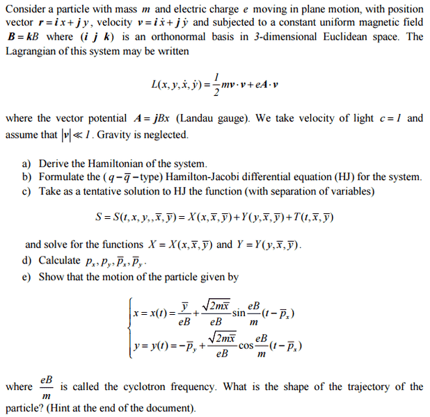

So far I have a solution for a) as
y%7D%20e%20B%20x%20-%20%5Cfrac%7B1%7D%7B2%7D%20m%20%28eBx%29%5E%7B2%7D%20-%20%28eBx%29%5E%7B2%7D.gif
For b) I formulate the equation as
20%28eBx%29%5E%7B2%7D%20+%20%28%5Cfrac%7B%5Cpartial%20S%7D%7B%5Cpartial%20t%7D%29%20%3D%200.gif
and so far for c) I have
My main idea at the moment is that as the Lagrangian was not time dependent, the Hamiltonian will not be. Following on maybe I can say that when separating variables T is constant so I can separate it so
but this is as far as I could get, as I couldn't think of how to separate them.
Any ideas, or are my problems due to a mistake in working?

The last three terms do not have the correct dimesions. I believe you have dropped some factors of ##2## and ##m##. So, check your derivation.
Alternately, you might see if you can first take the Lagrangian as given in terms of a general vector potential ##\bf{A}## and show that the Hamiltonian can be written nicely as ##H = \frac{1}{2m} (\mathbf{p}-e \mathbf{A}) \cdot (\mathbf{p}-e \mathbf{A})##. Then substitute the given expression for ##\mathbf{A}##.

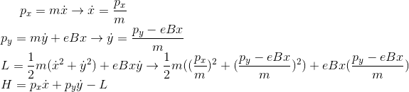

Okay, so I must have assumed something wrong early on or have made a pretty bad mistake in my work (not unheard of)
C%5C%20H%20%3D%20p_%7Bx%7D%20%5Cdot%7Bx%7D%20+%20p_%7By%7D%20%5Cdot%7By%7D%20-%20L%20%5C%5C.gif
So far so good. Just a matter of simplifying.
The Hamiltonian is the Legendre transformation of the Lagrangian:
## H = \sum_{i} \dot q_i \frac {\partial L} {\partial \dot q_i} - L = m(\dot x^2 + \dot y^2) + eBx\dot y - \frac {m} {2}(\dot x^2 + \dot y^2)- eBx\dot y##
## = \frac {1} {2m} (p_x^2 + p_y^2)##
