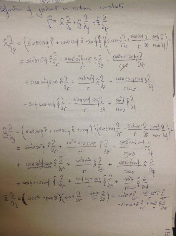

  • #40
Back at it! :)
OK After reading the following
strangerep said:
@JD_PM : Since PeroK has mentioned some adhoc techniques for finding constants of the motion, I'll sketch a more systematic approach below.
But first, here's a quick way to simplify any central force problem, and also discover conserved angular momentum...
The equation of motion, written in vectorial notation is
$$m\, {\mathbf a} ~=~ F(r) \, \widehat{\mathbf r} ~=~ - V'(r) \, \widehat{\mathbf r} ~,$$ where bold font denotes a 3-vector and an overhat denotes a unit vector. Therefore, $${\mathbf r} \times \dot{\mathbf v} ~\equiv~ {\mathbf r} \times {\mathbf a} ~=~ \frac{F(r)}{m} \, {\mathbf r} \times \widehat{\mathbf r} ~=~ 0 ~.$$Hence, $$ \frac{d}{dt} ({\mathbf r} \times {\mathbf v} ) ~=~ {\mathbf r} \times \dot{\mathbf v} + \dot{\mathbf r} \times {\mathbf v} ~=~ {\mathbf r} \times {\mathbf a} + {\mathbf v} \times {\mathbf v} ~=~ 0 + 0 ~=~ 0 ~.$$In other words, $${\mathbf L} ~:=~ ({\mathbf r} \times {\mathbf v})$$ is time-independent on solutions of the equations of motion, i.e., a constant of the motion.
I now have clear that for any central force problem, angular momentum is conserved.
Alright, I got that the ##\theta## component of angular momentum is conserved:
$$\frac{\partial L}{\partial \dot \theta} = \frac{1}{2 \alpha} (r \sin \theta)^2 \dot \theta = 0$$
But I still have to show that the other component (##\phi##) is conserved to show that angular momentum is indeed conserved.
Based on your insights I know that conserved angular momentum has two components, because as PeroK pointed out
PeroK said:
The component of motion in the radial direction makes no contribution to angular momentum.
I have two questions at this point:
1) How can I show that the component related to ##\phi## is indeed conserved? Note that the 'cyclic trick' doesn't work because ##\phi## appears explicitely on the Lagrangian.
2) Why the component of motion in the radial direction makes no contribution to angular momentum? (this question may be naive but I do not see it)
Thank you for your help.

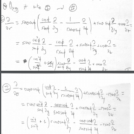

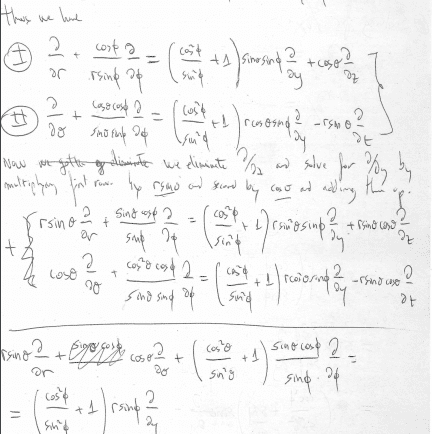

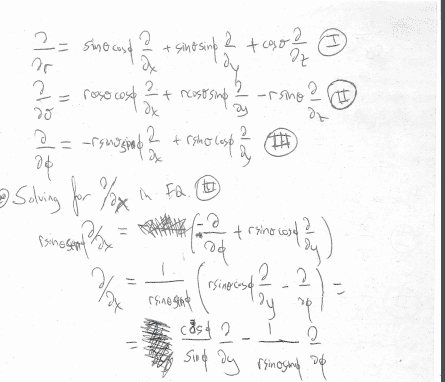

  • #46
PeroK said:
2) A neat trick to show that ##l_x, l_y## are conserved is to note that we chose ##\phi## relative to the z-axis and got ##l_z## as a conserved quantity. And, as we could just as well choose ##\phi## relative to the x or y axis, we must have ##l_x, l_y## as conserved quantities as well.
Alright let me show you what is the issue I have at the moment.
We already know how ##l_x, l_y## (I strongly suspect ##l_x## and ##l_y## shown below are not correct; they are simply ##p_r## and ##p_{\phi}##)and ##l_z## look like:
$$p_{\theta} = \frac{\partial L}{\partial \dot \theta} = \frac{1}{2 \alpha} (r sin \theta)^2 \dot \theta \hat \theta = l_z$$
$$p_{\phi} = \frac{\partial L}{\partial \dot \phi} = \frac{1}{2 \alpha} r^2 \dot \phi \hat \phi = l_y$$
