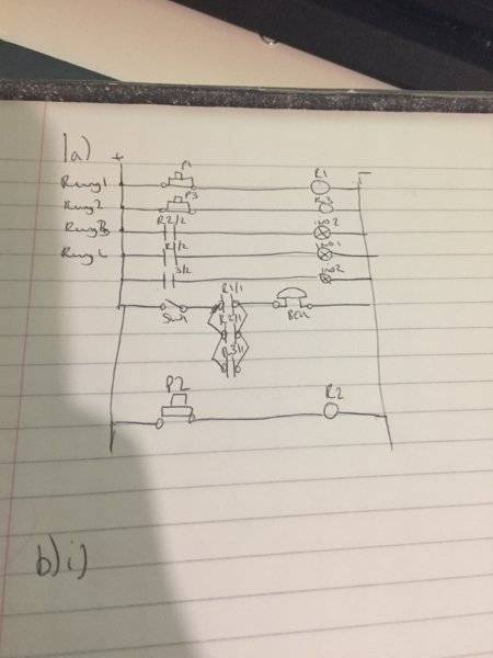

Connorm1
26

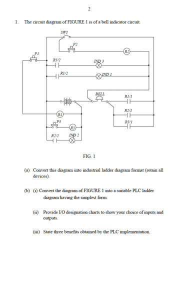

Uploaded as image 1 I will show my workings for 2 if 1 are in the right direction
I also don't understand what is meant as I/O Designation charts (nowhere in my study notes)
None
Uploaded as image 2 is my attempt.

1) Here is a link to some simple ladder logic with I/O charts. I expect this is what you are being asked for.
https://www.allaboutcircuits.com/textbook/digital/chpt-6/digital-logic-functions/
2) In you attempt, it appears you have mislabeled IND3. It looks like another IND2 to me.
Yeah you are correct, i meant IND 3 for rung 5 (N/O contactor 3/2). Also could you relink it, nothing there :) thanks!
I added the missing link to my original response.
Thank you, if No.1 is looking okay, i'll plod onto number 2 and get the rest answered for confirmation, thank you scott :)
