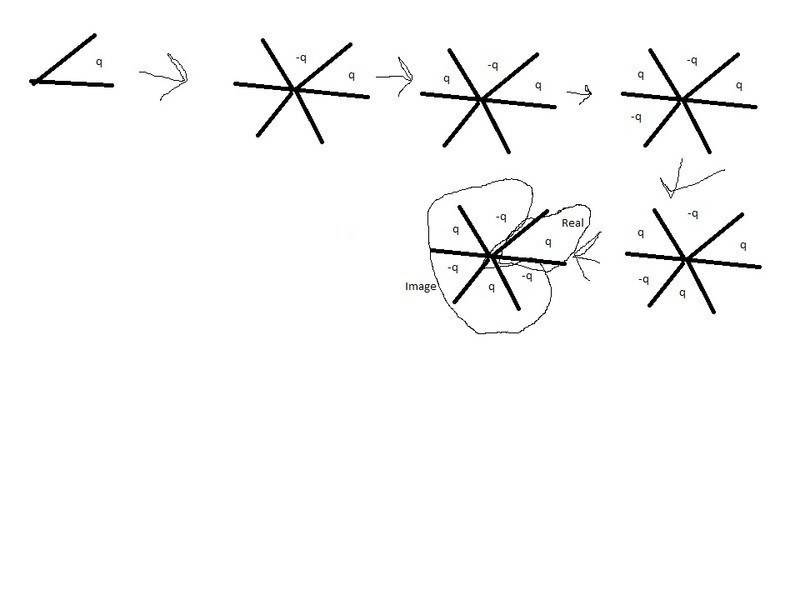

And another thing: if y-axis and x-axis are not perpendicular but they have an acute angle between them (say 60) and q is placed at (4,1) as in the old orthonormal system (am only placing coordinates to clear up the image). What will happen? What should we do then? How do we treat this case?
If your angle is theta then the number of image charges you would need would be 360/theta -1. This number must be an integer so only angles that divide 360 are allowed for this method to work.
nucl34rgg, I appreciate it a lot. But can you please tell me how do you know these equations? Because I read the whole course and didn't come across these equations.
And then you told me the nb of images but you didn't tell me where to locate them?
Ok this picture is embarrassingly bad, but it will serve the purpose. Pretend each angle between the lines is 60 degrees, and pretend that the figure is radially symmetric. All you have to do is reflect around and go around in a circle. Treat the one +q in the top right as real and the rest are image charges. Then the lines along the boundary for that +q have V=0.

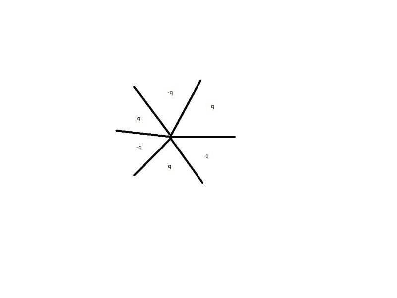

Thanks for your time, I really appreciate it. But what do you mean by "reflect around and go around in a circle"
You must be fed up by now, but I have to understand this by tomorrow.
Thanks again
start with the positive q charge on the top right. reflect over the v=0 boundary line. add a -q charge there and reflect over the next line...add a +q charge there, etc
Oh now i get it! Finally!
