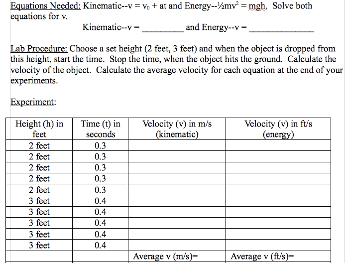

I'm having some difficulty in an online class.
Here is a screen shot for reference:
I'm doing a physics lab (screen shot is available above). The procedure says:
Choose a set height (2 feet, 3 feet) and when the object is dropped from this height, start the time. Stop the time, when the object hits the ground. Calculate the velocity of the object. Calculate the average velocity for each equation at the end of your experiments.
The small object I'm using is a small pecan in it's shell.
As you can see from the screen shot I have already recorded the time column from the experiment.
I'm having a difficult time with kinematic velocity (because I don't understand the equation) and the kinetic energy (because the KE formula asks for mass and I do not know the mass of the almond. This lab was not specific to mass, only specific of using a small object. More specifically it says: to use a "small object (thread spool, small ball)")
Kinematic velocity = v0 + acceleration*time
Kinetic Energy = ½mv^2 = mgh
I don't know how to go about either one of these. I'm sorry. The book is confusing me, too.
Welcome to PF.
One thing should make it easier for you.
The kinetic energy V doesn't depend on mass. If you will note it cancels out of both sides of the equation.
Hence your kinetic V is (2*g*h)1/2
Your kinematic V is simpler and is just g*t
Be careful of your units. 1 column is m/s. The other is ft/s.

Hi McSara! Welcome to PF! :smile:
It isn't kinematic velocity, it's a kinematic equation.
v is just ordinary velocity. :wink:
