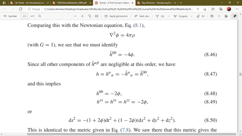

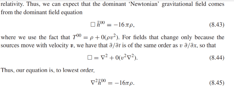

1) I did not understand how the ##\square## becomes ##\nabla^2## for this case.

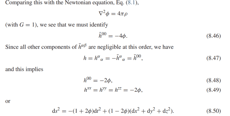

2) I did not understand equation 8.47 at all.
3) I also did not understand 8.49. Since he only defined $$\nabla^2\bar(h)^{0 0} = -16 \pi \rho$$.
Is there also terms like ##\nabla^2\bar(h)^{xx} = -16 \pi \rho##, ##\nabla^2\bar(h)^{yy} = -16 \pi \rho## and ##\nabla^2\bar(h)^{zz} = -16 \pi \rho## ?

For instance, by using 8.31 and 8.46 I can write,

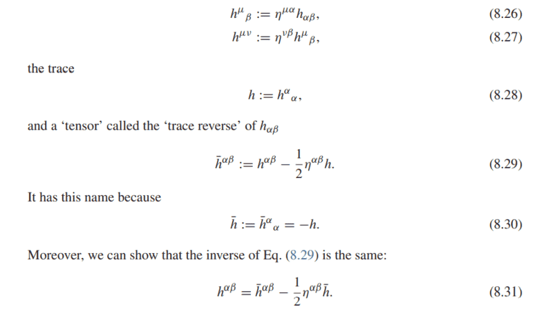

$$h^{0 0} = -4\phi - \frac{1}{2} (-1) \bar{h}$$ but what is ##\bar{h}## here ?
If we only know (8.45), how can we calculate ##h^{xx}## ?

1) The argument is that ##\partial_t## is of order ##v \partial_x##. Since ##v\ll 1##, the ##\partial_t## terms are negligible.
2) This is just computing the trace of ##h##. First step is the definition of the trace. Second step is using that ##\bar h## is the trace-reversed perturbation (take the trace of the definition of ##\bar h_{ab}##). Last step is using that the 00 component is assumed to completely dominate ##\bar h##.
3) No. The entire argumentation is based on the 00 component of the stress energy tensor dominating and all other terms therefore being negligible.
Likes vanhees71 and Arman777
Thanks for your answer.
1) I understand this one
2-3) So you mean ##\bar{h}^{00} \gg \bar{h}^{11}, \bar{h}^{22} , \bar{h}^{33}## ?
If that's the case, then how can we calculate ##h^{xx}, h^{yy}## and ##h^{zz}## ?
Okay, solved it. Nvm
