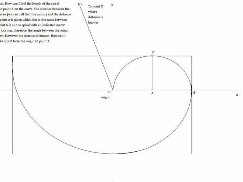

This is a logarithmic spiral. How can I find the length of the spiral (curve) from the origin to point X on the curve? The distance between the origin and the point is given (we can call that the radius) and the distance between the origin and point A is given which this is the same between points A and B and C. Point X is on the spiral with an indicated arrow pointing towards it. The location, therefore, the angle between the origin and this point is unknown. However the distance is known. How can I find the total length of the spiral from the origin to point X?

1. ##r=ae^{b\theta}##
2. ##L=r\theta##
Do I need to solve for theta then use L=r(theta) to find the total length?
I'm having troubles finding the terms for the first equation.
That is a good idea.
Im having troubles finding the terms for the first equation.
You know that A and B satisfy the equation for the spiral. This allows to determine a and b.
Are you referring to the points A and B? So my values at point A and B correspond to the a and b terms in the equation?
Sure
No. The names are a bit misleading in that respect.
