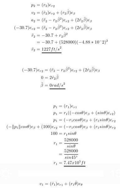

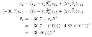

But the correct answer is 1227 ft/s^2.
Thanks.
Check your units for r2.
Thank you. I was able to find part a) and r1. However, I was unable to find r^.. in part b). This is what I have so far:
I don't know how to integrate the acceleration vector to velocity vector it seems.
