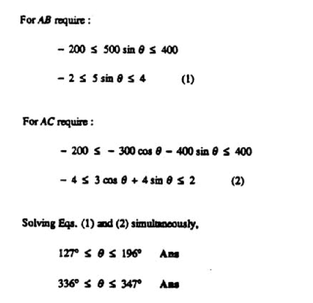

I am trying to solve the simultaneous inequalities (1) and (2) shown in the following image. The solution is provided, but I'm not sure how they solved for it.
http://[ATTACH=full]199971[/ATTACH]
[h2]Homework Equations[/h2]
N/A
[h2]The Attempt at a Solution[/h2]
[/B]
I tried to solve this set of simultaneous inequalities by multiplying (1) by 4, multiplying (2) by -5, and adding them together. My thought was that this would cancel the sin(θ) component and allow me to solve for the range of allowable angles. It did not seem to work.
How does one go about solving simultaneous inequalities?

Write ##3 \cos \theta + 4 \sin \theta## as ##A \sin(\theta + \phi)## for known values of ##A,\phi##. This is done using trigonometric identities ##A \sin(\theta + \phi) = A \sin(\theta) \cos(\phi) + A \cos(\theta) \sin(\phi)##, so you need to solve ##A \cos \phi = 4, A \sin \phi = 3##. That is easy enough to do if you use additional trigonometric identities.
Anyway, from the two equations you will get ##a_1 < \theta < a_2## and ##b_1 < \theta + \phi < b_2##, so then you just need to figure out the common ##\theta##-region.

Hi Ray,
That is a clever idea. I used it to find part of the solution but couldn't get the rest. Not sure what I'm doing wrong.
##3cos(\theta) + 4sin(\theta) = Asin(\theta + \phi)##
##Asin(\theta + \phi) = Asin(\theta)cos(\phi) + Acos(\theta)sin(\phi)##
##Acos(\phi) = 4## and ##Asin(\phi) = 3##
Thus ##tan(\phi) = 3/4## and ##\phi = 36.87, A = 5##
Now we can write inequality (2) and substitute the new expression:
##-4 < 3cos(\theta) + 4sin(\theta) < 2##
##-4 < 5sin(\theta + 36.87) < 2##
Solving, we have ##270 < \theta < 346.71##. But from inequality (1), it must also be that ##336 < \theta < 53.13##. So one of the solutions is ##336 < \theta < 346.71##.
But how do we get the other solution?

Remember that sin(x)=sin(180-x).

Consider the boundary 3cosQ + 4sinQ=2. Your approach, as I understand it, rewrites this as 3cosQ = -4sinQ+2, then squares to produce 9cos2Q = 16sin2Q-16sinQ+4. You then rearrange this into a quadratic in sinQ.
But -3cosQ + 4sinQ=2 leads to the same quadratic, so half the solutions to the quadratic are solutions to that equation. You then have to weed those out.
If you are unconvinced, write out the complete solutions using both methods and post them.
