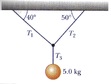

This is my first post...is there a way to add a picture from my own computer to a post?
similar to this problem but with different numbers
In my problem, C=T3, B=T2, and A=T1. The angle on the left is 30 and the one on the right is 45
[tex] \vec{F}_{net} = \Sigma \vec{F} = m \vec{a}[/tex]
What I know...
1. T_c=w
2. T_a sin 30 + T_b sin 45 = w
3. T_a cos 30 - T_b cos 45 = 0
4. sin 45 = cos 45
T_a sin 30 + T_b cos 45 = w
becuse of # 3 above, I get
T_a sin 30 + T_a cos 30 = w
T_a(sin 30 + cos 30) = w
T_a(1.366) = w
...I'm stuck here. Please help direct me to find T_a in terms of W. As shown above I came up with "T_a=w/1.366" but the book came up with "T_a=.732w" Thanks is advance for the help.
Welcome to PF!
Hi dbakg00! Welcome to PF! :smile:
(try using the X2 tag just above the Reply box :wink:)
dbakg00 said:
… I came up with "T_a=w/1.366" but the book came up with "T_a=.732w"
erm :redface: … they're the same! :smile:
w/1.366 is the same as 0.732w, so it is both correct
I'm not seeing how those two are the same, would someone mind clarifying for me?
w/1.366 = w (1/1.366) = w(.732) :wink:
thank you...i've been staring at this problem for so long, even the obvious becomes oblivious to me!
