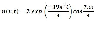

Thank you very much for your help Chisigma. I e-mail my professor with regards to this question and she only replied me her answer which is :
https://www.physicsforums.com/attachments/514._xfImport
I understood your working but my professor claim that the above is the correct answer and now I am really confused.
Sorry I tried my best to type this out using LaTeX but I simply don't know how to thus I insert a picture for illustration purpose.
I think that you have a typo in the initial statement of the problem. You wrote
superbread88 said:
\[\frac{\partial u}{\partial t}=4\frac{\partial^2 u}{\partial x^2}\]
for \(t>0\) and \(0\leq x\leq 2\) subject to the boundary conditions
\[\color{red}{u_x (0,t) = 0}\mbox{ and }\color{red}{u(2,t) = 0}\]
and the initial condition
\[u(x,0) = 2 \cos \left(\frac{7\pi x}{4}\right)\]
with the boundary conditions given as $u_x (0,t) = 0$ and $u(2,t) = 0$. Chisigma interpreted this as $u (0,t) = 0$ and $u(2,t) = 0$ (with no partial derivative in either condition). It looks as though you should have written $u_x (0,t) = 0$ and $u_x(2,t) = 0$ (with a partial derivative in both conditions). Chisigma's solution can then quite easily be modified to give the professor's solution.
