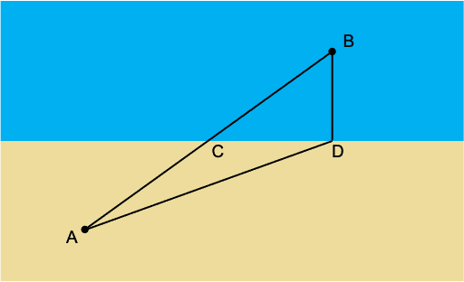

Perhaps you might wish to explore the following situation. A lifeguard can run on sand at top speed ##v_s## and swim in water at top speed ##v_w## (##v_w<v_s.##) He sees a swimmer in distress at coordinates (X,Y) relative to him. Assuming that he runs and swims in straight lines, at what angle must he aim himself while running in order to reach the swimmer in the shortest possible time? Hint: You might recognize this as an analog of Snell's law.

No, the point is to show you how to apply the basic idea of the calculus of variations to this simple problem. You equated that idea to taking derivatives and, as you found out, it's not the best way to proceed. The goal is to find point ##x## so that the time when the lifeguard crosses at that point is at a minimum. To achieve this goal,
  1. Assume that you have found such a point ##x##.
  2. Vary the path by moving away from it by a small amount ##\delta<<x##.
  3. Find what condition must be satisfied for the difference between times along each path to be zero in the limit ##\delta\rightarrow 0##.
I know this looks suspiciously the same as taking derivatives, but you have already seen where that took you, so bear with me. I will get you started and you will have to wrap it up if you are so inclined.
The two times to reach the swimmer are $$\begin{align} & T=\frac{\sqrt{h_s^2+x ^2}}{v_s}+\frac{\sqrt{h_w^2+(w-x) ^2}}{v_w} \nonumber \\ & T'=\frac{\sqrt{h_s^2+(x+\delta) ^2}}{v_s}+\frac{\sqrt{h_w^2+[w-(x+\delta) ]^2}}{v_w} \nonumber \end{align}$$We want$$\delta T=T'-T=(T'_s+T'_w)-(T_s+T_w)=\delta T_s+\delta T_w=0.$$ I will take the first difference and rely on you to find the second, add them and set the sum equal to zero.$$\delta T_s=\frac{1}{v_s}\left[{\sqrt{h_s^2+(x+\delta) ^2}}-{\sqrt{h_s^2+x ^2}}\right]
=\frac{{h_s^2+(x+\delta) ^2}- ( {h_s^2+x ^2}) }{v_s[\sqrt{h_s^2+(x+\delta) ^2}+\sqrt{h_s^2+x ^2}]}.$$ Upon expansion of the terms in the numerator, we get
$$\delta T_s=\frac{2x\delta+\delta^2 }{v_s[\sqrt{h_s^2+(x+\delta) ^2}+\sqrt{h_s^2+x ^2}]}.$$ Up to this point the expression is exact. In the limit ##\delta <<x##, $$\delta T_s \approx \frac{2x\delta}{2v_s\sqrt{h_s^2+x ^2}}=\frac{\delta}{v_s}\frac{x}{\sqrt{h_s^2+x ^2}}=\frac{\delta}{v_s}\sin\theta_{\!s}.$$See how it works? It would be nice if you completed the derivation and posted it here for everyone's benefit. I used this to derive Snell's law using Fermat's principle when I taught introductory algebra-based physics.

In this case, the "variation" and the existence of the minimum need to be established first. In the diagram below the lifeguard starts at point A and wants to end up at point B. He could go along the straight path ACB, but that's not minimum time. If crosses to the left of C, clearly the path is longer both on sand and in water and so is the time. However, if he crosses at a point to the right of C, he can do better because he trades distance in the medium where he moves faster for distance in the medium where he moves slower.
Can he do so indefinitely to the right of C? No. If he goes to the right of D, the distances in both media increase and so will the corresponding times. Therefore, somewhere between points C and D there must be an optimum crossing point. It follows by looking at the drawing that the faster he can move on sand relative to water, the closer the optimum point is to D.
I think this problem encapsulates the essence of the calculus of variations and that is why I proposed it to @erobz. It is simple to understand, simple to explain and simple to deal with.

Yes, some students get your path ACB and some get ADB. Some get where crossing is to the left of C and some where the crossing is to the right of D. But most get a path between C and D. Now I do not tell them at first we are looking for the path with minimal time but just "calculate the time of travel for your path, the speed in medium 1 is... and the speed in medium 2 is". Then I ask the students who got those four paths about their result and I present it on the blackboard. Then I say to them "we can see something interesting here already, can you discuss with each other what you think that is".

Doing the algebra:
$$ \delta T_w = \frac{1}{v_w} \left( \sqrt{ {h_w}^2 + \left( w - \left( x- \delta\right) \right)^2} - \sqrt{ {h_w}^2 + \left( w-x\right)^2 } \right) $$
Multiply the numerator by its conjugate, expand, and cancel opposite terms:
$$ \delta T_w = \frac{1}{v_w} \left( \frac{ -2\left( w - x \right) \delta + \delta^2 }{ \sqrt{ {h_w}^2 + \left( w - \left( x- \delta \right) \right)^2} + \sqrt{ {h_w}^2 + \left( w-x\right)^2 } }\right)$$
Then apply the condition ## \delta \ll x ##:
$$ \delta T_w \approx - \frac{ \left( w - x \right) \delta }{ \sqrt{ {h_w}^2 + \left( w-x\right)^2 } } \implies - \frac{1}{v_w} \sin \theta_w $$
Putting that all together with ## \delta T_s + \delta T_w = 0 ## we arrive at ( spoiler alert ) Snells Law:
$$ \frac{\sin \theta_s}{v_s} = \frac{ \sin \theta_w}{ v_w} $$
