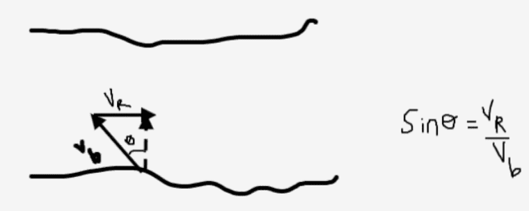

A boat moves at 8m/s across a river that flows at 2m/s. At what angle must the boat travel so that it moves in a straight line that is perpendicular to the direction of the river's flow?
Trignometry
I'm assuming the boat is traveling north at an 8 m/s and the river is flowing east at a 2 m/s. For the boat to move in a straight line, it has to aim at an upstream angle given by #theta#.
Using SOH CAH TOA, ##v_r = 2m/s##, ##v_b = 8m/s##
$$\theta =\sin^{-1} \frac{v_r}{v_b}$$
$$\theta = 14 ~degrees $$
Close : how did you calculate it ?
I just used trigonometry to find. According to the answer sheet, the angle is 75.5.
It should be noted that the boat will move in a straight line regardless how it is aimed because its acceleration is zero. Of all the possible straight lines, we are looking for the one that is perpendicular to the current.
Reason I asked is the answer's ~14.5 give or take, which is what a calculator should spew out. "14" seems odd. Also, brackets in your calculation.
paulimerci said:
I don't understand, that's what I did in post #1.
No, it is not. You went from an equation with variables straight to an answer without showing your calculation.
Anyway, you need to review basic trig. The answer of 75.5 degrees is trivial.
I followed this video, and I was quite confused with the answer I got.
I think I understand where my mistake was.
So I need to do 90-theta = 75.5, right?

I thought he did show his reasoning and calculation that ##\theta = sin^{-1}(\frac{2}{8})##

Are you defining ##\theta## with respect to a different direction than directly across the river?
Hm ... either I missed the 2 and the 8 in the original post or he backfilled. It would not surpise me to find that I overlooked it.
I using the theta that he drew. sin theta is NOT Vr / Vb. As he correctly figured out in post #11, the answer is sin (90 MINUS theta) = Vr/Vb
Sorry, I'm probably being dense, but how is it possible that the boat has a speed of 8m/s and the river is moving at 2m/s and it takes an angle of greater than 45 degrees to move straight across the river...?
HA, he mixed up the 8 and the 2 and I just went along with him. Good thing SOMEBODY here is paying attention. I was also fooled by the fact that he said the answer is 75. Had he got his numbers right he would have gotten 15 (well, 14.47) and would have questioned the book's answer. The book's answer is right ONLY if you take theta from the perpendicular to the bank, not to the bank, which it normally is taken as in such problems.

It was in his OP in two places. It was in his LaTeX work, but initially the LaTeX had an extra "{" character in it that messed up the rendering, so likely you saw his OP before that was fixed. It was also in his hand-drawn sketch that was attached to the OP, but I usually don't click into those unless I have to.
