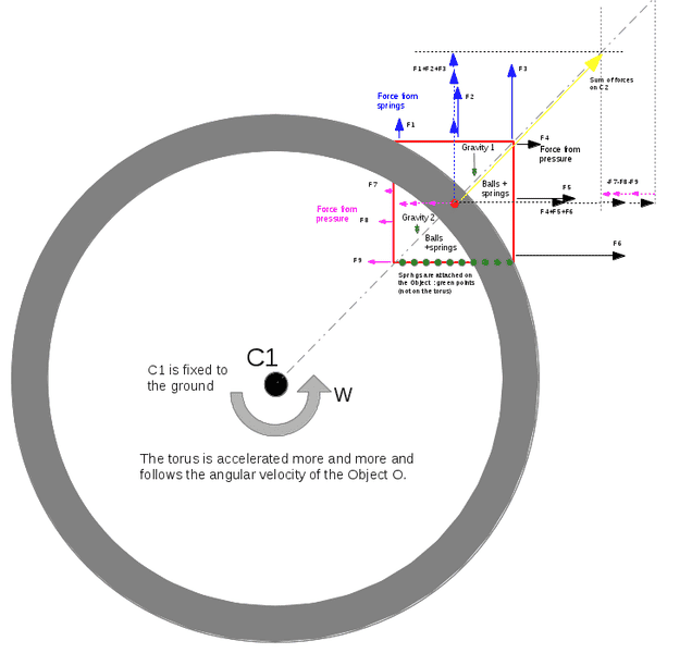

Hi,

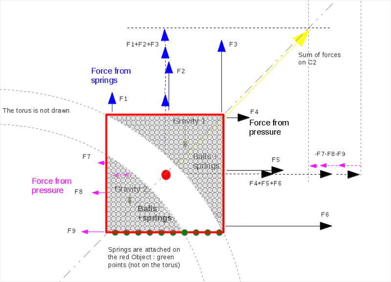

I imagined this device and I don't understand where is the error. I posted here because it's a simple mechanical device, I have trouble with the sum of torque. The potential energy must be constant. I think I forgot a torque, if you see where ?

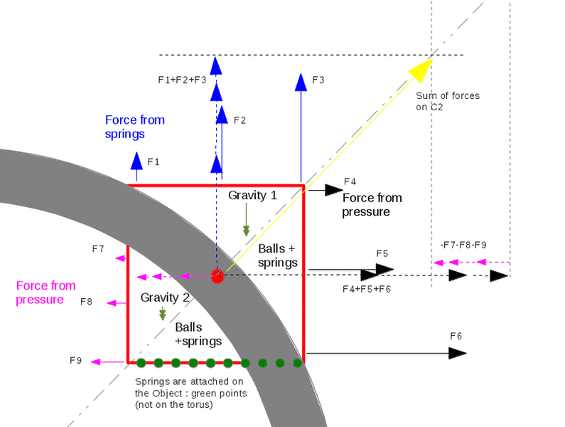

A torus turns counterclockwise around the center C1. C1 is fixed to the ground. The center C2 is fixed to the torus and a square object can turn around C2. I put inside the square Object a lot of small balls where there isn't the torus. Each ball is attracked by a spring (not drawn). The springs attrack balls like gravity can do, but Gravity1 is higher than Gravity2. I called it gravity but it's not a gravity it's just for have a pressure with balls like water can do in a recipient. The springs are attached on the green points, and the green points are on the square Object not on the torus. I drawn all forces I see and I can have the sum of forces on the center C2 like the yellow force so the torus don't receive a torque from C2. In the contrary the square Object with balls inside receives a net torque on it. The square Object will turn counterclockwise BUT I turn the torus counterclockwise more and more in the time for have the same angular velocity for the square Object and the torus. The angular velocity of the torus "follows" the angular velocity of the square Object for keep constant the angle. I need an energy for accelerate the torus but this energy can be recover later. In the contrary, I don't give an energy for rotate the square Object but with time it turns more and more, and the potential energy seems to increase. I need to accelerate more and more the torus but I don't think the problem come from this particulary. What's wrong in this device ?
The device:
The forces:
Where the balls are inside the square object:

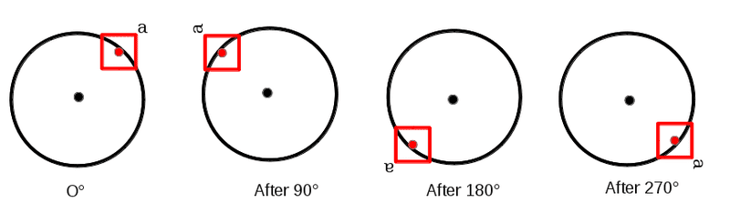

Several positions of the device, for show the angle:

I'm not trying to be rude, but your diagrams and your descriptions are very convoluted. I don't think anyone can give you a straight answer until you simplify some of this.

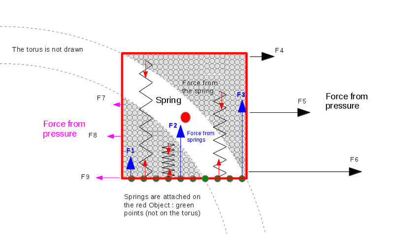

You're right, I drawn so many forces. Maybe, first, just study the square Object without the torus. I drawn 3 springs for show where they are, one end of a spring is attached to a green point and another end to a ball. I don't drawn all green points. There is one spring for one ball. The forces F4, F5 and F6 come from the pressure of balls, it's like the pressure in water with gravity. The forces F1, F2 and F3 come from the forces on the green points from springs, all springs attrack the balls to the "bottom" (bottom on the image). I drawn red forces for show how a spring attrack. F1+F2+F3 is lower than F4+F5+F6 because the torus has a curved shape. The forces F7, F8 and F9 come from the pressure in another part of the square Object, it's not the same force of attraction so forces are smaller than the right part. The square Object with the forces of pressure and force from springs are like that:
Tell me if that first step is ok for you please ? Maybe I'm wrong in these forces.

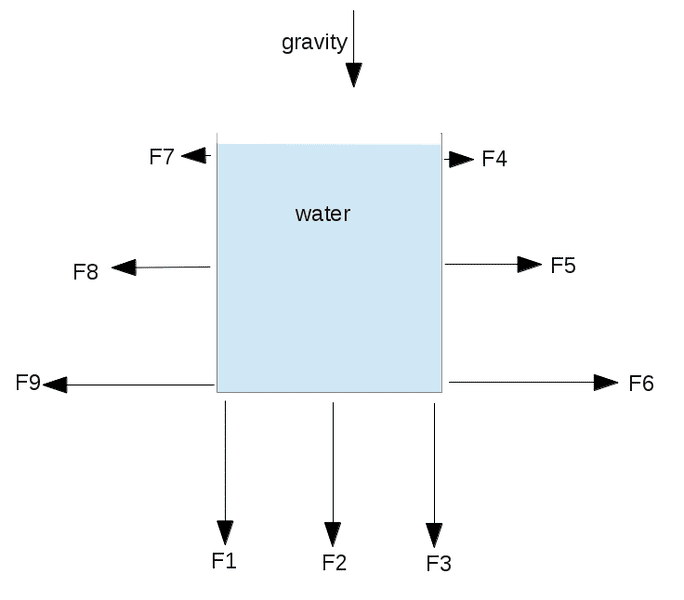

With gravity + water, there is forces from pressure at left, at right and at bottom, I have this : (I did not draw all forces)

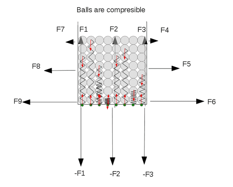

If I want to have the same pressure at left and at right but now with balls and springs without gravity (I can't draw all springs, but there is one spring for each ball). Note the forces from springs are to up and there is forces of pressure at bottom too. I have this:
Now, with the square object I want 2 areas (areas are separated) with 2 differents attraction (attraction1 > attraction2) but it's the same, I use springs and balls (balls are compressible), like that do you understand my forces ?
Note there is the torus so some forces are on the torus not on the square object.

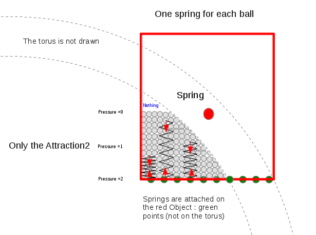

I changed my diagram maybe like that it's clear enough ?
I noted the pressure at right from 0 to 10 and the pressure at left from 0 to 2 (it can be bars for example). So, I drawn only the forces from the springs. The pressure gives forces at right and at left that I symbolized with 3 different forces in my last messages. The balls are compressible. It's possible to have a torque on the object and not on the support.
With only the Attraction2 :
There is not a up force from the springs because balls pressure to the bottom in the same time. There are forces from pressure at left.
With only the Attraction1:
Here, there are up forces from the springs.
