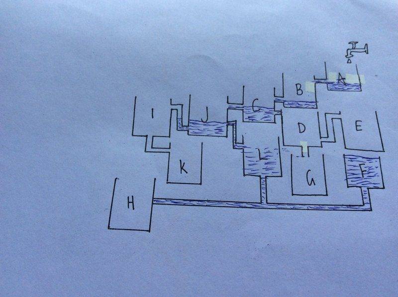

  • #61
Dadface said:
If it fills to the top then obviously tank A fills up first. If it doesn't fill to the top then tank F fills up first
According to your own interpretation, tank F will not necessarily fill up first if tank A doesn't fill to the top.
If the input & output flows in tank A are the same when, say, the tank is ¾-filled, then tank J might be the one to fill up first. Assuming the pipes give the same restriction to the flow everywhere (Again, an assumption), the pipe J-K will also need the equivalent of a ¾ of the tank height to reach the input flow. That will never happen since the pipe J-K is about halfway into tank J.
This reasoning could also apply to tank C.
And given the proper flow and restriction, if tank C level gets higher than the input pipe, but not enough to reach the top, it could restrict further more the flow in tank B which may rise to the top first.
Is that constructive enough?
The point is that assuming there are no assumptions is not a valid argument as it clearly leads nowhere. The single drop dripping from the faucet is the information that stipulate the flow is slow enough that we can assume no pipe restriction, which answers your question:
Dadface said:
Most people here seem to be of the opinion that the second answer is the correct answer. But can they justify that answer?
A question that was already answered in post #2 and was also pointed out to you in post #45. But you still refused to admit defeat in post #46 by ignoring the justification given to you. The droplet symbol means «no matter how small are the pipes, they will never be a restriction».

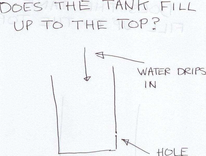

I can't understand why some people here are finding the point I am making difficult to grasp. It doesn't make unjustified assumptions. It is simple, it is obvious. It can be answered in terms of physics and it can be answered in terms of pure straightforward common sense and general knowledge.
I have tried in many different ways to put my point across and now I'm going to try again by reiteration of a question I posed earlier in this thread. Here goes:
WATER CONTINUES TO DRIP INTO A BUCKET WHICH HAS A HOLE IN THE SIDE. WILL THE BUCKET FILL UP?
That's it, I have described a situation which is analogous to the water dripping into Tank A as in the original question set by fahraynk. So will the bucket fill up or won't it? The best response would be that there is no definite answer to the question because not enough information has been given.
Similarly if I ask whether tank A in the original question fills up or not, the best response again would be that there is no definite answer because not enough information has been given. Despite that some people assume that tank A will not fill up. Where's the proof for that? And where's the proof for the assumption that may be made that Tank A will fill up? There is no proof to back up either assumption or any other assumptions.
My answer to the questions would be that I don't know the answers but just as there is a possibility that the bucket or tank won't fill up there is also a possibility that they will fill up. So Tank A might fill up first and to paraphrase fahrank if it does so it's a trivial solution. I'm not sure that I agree with the word trivial but even if it is trivial it is still a possible solution.
That's it, like NTL 2009 I'm done. I don't have the inclination to keep going over the same ground. On top of everything else I'm getting things like looping the loop, the Coriolis effect and particular compactification entering the discussion.o_O:biggrin:

Ok...
No.
Why? Because you don't know the flow rate of a drip? Ok, fine. I don't think that's reasonable, but it isn't an absolute, so so be it - you can have it. If that's your objection, then I get what you are saying and I think most others do as well. That said, if someone sees a question like this on a test, they should answer it and not punt. I wouldn't want our students to get into the habit of diving so deep they can no longer see the surface, causing them to waste time and get wrong answers on tests unnecessarily.

  • #82
ok so us non-geniuses ( sorry i know i shouldn't even be on this site...help I am lost) without all the formulas and equations, arguments and headaches think its K. i do (believe it or not ) understand why F must be the answer i guess...but i think in a race at the county fair, K might win lol! So, I guess its wrong of me to have assumed the tanks and attached fill tubes are of equal size and capacity then huh?
  • #83
You are not wrong about the tank and tube size, they are all the same. Elevation is the only difference as to water flow and as one that has worked with water levels in many ways, for me the answer came quick and I believe the puzzle is not about intelligence but rather the ability to make mental observations.
Flipping the picture upside down and being able to mentally see the proper flow and elevations might require intelligence ?? :smile:

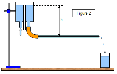

Please bear in mind that my take is that there is a possibility that Tank A fills up first but additional information is needed to disprove that or to prove it. But the possibility remains. I'm going to try a different approach of defending my position by writing a series of statements and if anyone can be bothered, look at each statement and decide whether its true (T), false (F), possibly true/false (P) too vague to reach a decision(V) or whether it falls under any other category (C). If you do this It might help to clarify my position. But then again it probably wont. I will start with the tank being empty
  1. Water drips into the tank.
  2. As time proceeds the water level in the tank rises.
  3. There is a tube sticking out of the side of the tank.
  4. The internal radius of the tube seems to be smaller than the drop size.
  5. It could be a capillary tube.
  6. When the water level reaches the level of the tube the water starts to drain out of the tank.
  7. It is relevant to consider the average volume per second of water entering the tank (Ve) and the average volume per second of water leaving the tank (Vl)
  8. Vl and Vc both have very low values
  9. As soon as the water starts to drain Vl becomes bigger than Ve and the average water level drops.
  10. On second thoughts that won't happen. What might happen is that Vl becomes equal to Ve and the water level fluctuates at the height of the tube.
  11. On third thoughts Vl becoming equal to Ve as soon as the tube height is reached seems to be a bit of a coincidence.
  12. On fourth thoughts when the water starts to drain Vl might be smaller than Ve.
  13. If Vl is smaller the water level continues to rise,but now more slowly.
  14. If the water level rises the pressure difference at the two ends of the tube increases.
  15. As the pressure increases Vl increases.
  16. Eventually the water level will reach a height such that an equilibrium situation is reached where Vl becomes equal to Ve.
  17. If equilibrium is reached the average water level will stay constant but will fluctuate.
  18. If the tank is not tall enough equilibrium may not be reached and the tank will fill up and overflow as more drops are added.

I have been trying to show that there is a possibility that Tank A fills up first. What happens beyond Tank A -Tanks B,C,D etc is totally irrelevant to the point I'm trying to make because if Tank A does fill up first the original question has been answered. I have been having trouble convincing people here that the possibility exists. You may have noticed that. So in one of my attempts to explain my point I stripped away everything else that's irrelevant and presented the problem with the relevant parts only, tank A, the pipe poking out of it and the water dripping into it. I then changed it slightly with the assumption, possibly mistaken, that describing something more familiar would show, more clearly, that the analysis is not a difficult one. So the tank became a bucket the pipe became a hole and the the dripping water became, well, dripping water. So the situation I described was an analogy but it was a good enough analogy for the purpose I was trying to show.
Just as there is a possibility that Tank A does fill up first there is also a possibility that it doesn't fill up first and if that's the case different bits of the rest of the system can be relevant. But looking at it now even that can be simplified by stripping away the distracters such as.D,E,G and H.
