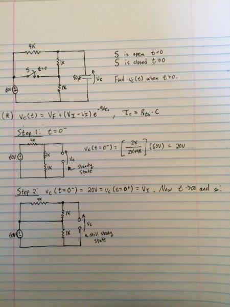

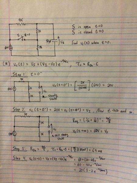

I had a question about transient circuits. I was asked to find an expression for ##v_C(t)## at any time ##t## for the following circuit. My work is shown in the image below.
Then the response is interrupted at ##t = 50 ms## by the switch being opened and I'm asked to derive a new equation for ##v_C(t)## for ##t > 50 ms##.
Handwritten circuit analysis on lined paper: a 60V source, 4K resistor, two 1K resistors and a capacitor Vc with switch S, for t<0 and t>0, with the formula vc(t) = VF + (VI - VF)e^(-t/tc) and steps for t=0- and t=infinity.
It seems like the capacitor is in steady state operation for any time ##t## regardless of the switch ##(i = 0)##. When I consider ##t \rightarrow \infty## in step 2, the extra wire seems to be confusing me for some reason.
The ##4k## and ##1k## are actually in parallel (for convenience, ##R_{eq} = \frac{4k}{5}##), but how am I to find the voltage across the open terminals in this case?
Is it simply the voltage across all of the components? Then ##v_c(t \rightarrow \infty) = 60V = V_F## since the remaining ##1k## and ##R_{eq}## are in series.

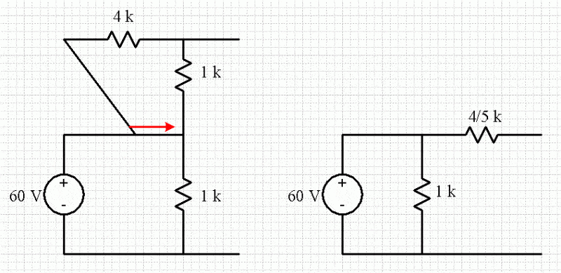

While the switch is closed that horizontal path is all one node. You are free to move any connections to that node to any other location along that node. So see how the circuit looks if you slide the point where the 4 k resistor connects along to where the 1 k resistors connect:
Left: circuit with a 4 k resistor on top, a 1 k resistor in a vertical branch, a red arrow along a horizontal wire, a 1 k resistor below, and a 60 V source on the left. Right: equivalent circuit with a 60 V source, a 1 k resistor in parallel, and a 4/5 k resistor at the top.
Does that help? You should be able to tell immediately what the Thevenin values will be for that.

Ah, no. When you want to find the Thevenin resistance you first suppress the sources. In this case that means replacing the voltage source with a short circuit, so the 1 k resistor gets shorted out too...
I still can't seem to see ##v_C(t \rightarrow \infty) = V_F## for some reason. I know that ##60V## needs to drop across the ##\frac{4k}{5}## plus the capacitor so that ##v_c = 60V - v_R##. There's no way I can see to get that voltage though.
EDIT: Wait wait, there's no current in that right side there is there? If there was no current, that would mean ##v_C(t \rightarrow \infty) = 0 V##!
Is that the case?
Not quite. The capacitor voltage will head towards the open circuit (Thevenin) voltage. At steady state the capacitor current is zero so the current through the 4/5 k resistance is zero, too. Zero current through a resistor means no change in potential from one end to the other.

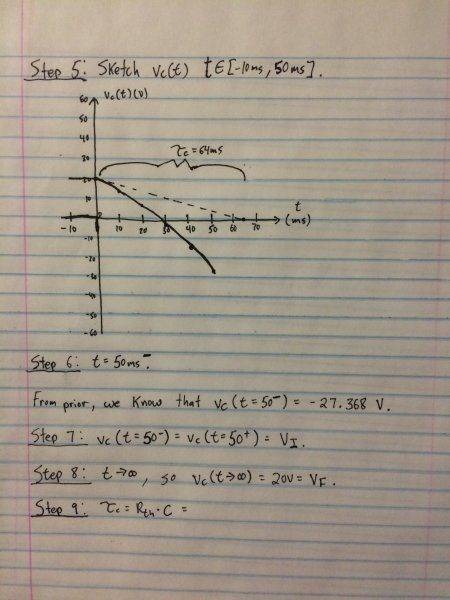

Indeed, so this is what I got for that first portion:
Handwritten notes solving a transient RC circuit: a 60V source, 4k and 1k resistors and a 90 µF capacitor, with switch S open for t<0 and closed for t>0, finding vC(t) for t>0 in steps.
Then I continued by doing this:
Handwritten notes titled Step 5 showing a sketch of v_C(t) for t from -10 ms to 50 ms, with a solid decaying curve crossing zero near 50 ms, a dashed straight line, and a label tau_C = 6.4 ms; followed by Steps 6 to 9 with v_C(t=50-) = -27.368 V and v_C(t->inf) = 20 V.
I stopped there since I just wanted to ask, since I'm back to the circuit in step 1, the Thevenin resistance would be ##2k## because the ##4k## gets shorted right?
The time constant would then be easily found.
Then I would simply plug everything into:
$$v_C(t > 50 ms) = V_F + (V_I - V_F)e^{\frac{-(t - t_1)}{\tau_C}}$$
Where ##t_1 = 50 ms##.
EDIT: Disregard the plot. I forgot to tack on a negative sign when calculating graph points.
I don't know what's going on today. Otherwise I think the rest of the process is correct.
For the sake of not wanting to mess everything up.
##v_C(t = 50^-) = 41.69 V = v_C(t = 50^+) = V_I##
##v_C(t \rightarrow \infty) = 20V = V_F##
##\tau_C = R_{th}\cdot C = (2000)(80 \times 10^{-6}) = 0.16s = 160 ms##.
##v_C(t > 50) = 20 + (41.69 - 20)e^{\frac{-(t - 50)}{160}} = 20 + 21.69e^{\frac{50-t}{160}}##

I understand everything in the first image with the three circuits is correct now up to step 4 where I found ##v_C(t > 0)##. Up to this point I have:
##v_C(t = 0^-) = 20 V = v_C(t = 0^+) = V_I##
##v_C(t \rightarrow \infty) = 60V = V_F##
##R_{th} = \frac{4k}{5}##
##\tau_C = 64 ms##
##v_C(t > 0) = 60 - 40e^{\frac{-t}{64}}##
The plot i did in step 5 was silly because i forgot to tack on a negative sign to the exponential.
