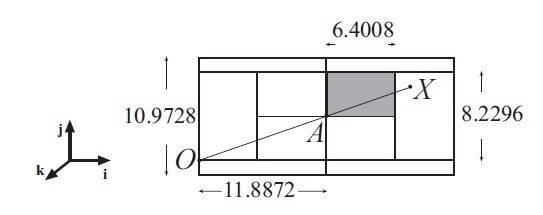

I already made a start to this question, the position vectors below are worked out in the first part of it, I am 99% sure they are correct so, on to the bit I am stuck on. :)
A player stands with his feet at the point O and serves the ball from a point Y at
a height of 2.4000m vertically above O. Assume that the ball then travels in a
straight line directly over the net at the midpoint A, which is at a height of
0.9144 m, before bouncing at the point X.
diagram here = https://www.physicsforums.com/attachment.php?attachmentid=32722&d=1299067106
find the dot product of the following position vectors, OX & YX, hence find the angle between them
a=OX=[19.2038i, 6.6475j, 0k]
b=YX=[19.2038i, 6.6475j, -2.4k]
find the cross product of the following position vectors, OY & YX, hence find the area of the triangle they form
a=OY=[0i, 0j, 2.4k]

Do the products with their Cartesian components:
[tex] A \cdot B = A_x B_x + A_y B_y + A_z B_z[/tex]
[tex] A \times B = \left| \begin{array}{ccc} \hat i \ \ \ \hat j \ \ \ \hat k \ \ \\ A_x \ A_y \ A_z \ \\ B_x \ B_y \ B_z \ \\ \end{array} \right| [/tex]

One thing that's troubling me, is the -2.4k term correct? that would be b3 on the cross product part of the question
Ive just run the numbers and for the cross product and i get
a x b = -15.954i + 46.0891j + 0k
How does this apply to the area of a triangle?

I mean is it ok to have a negative term in these general methods? if you look at my post above, youll see what i got at the end of it. I can work out the area of the triangle the normal way and it doesn't match with this result
A negative component in the cross product is okay; it's a vector normal to the plane that the two vectors define. What's the magnitude of the result? That should be the area of the parallelogram defined by the two vectors. The area of the triangle would be half of that.
I get the magnitude to be 52.417, so the area of the triangle is half of this =26.2085
I tried to check it using 1/2bh, which is 0.5 x 19.2038 x 2.4 = 23.0446
Id expect the area of the triangle to be the same no matter which method I used, so its clear something is wrong here. :)
For your vectors
a = [0i, 0j, 2.4k]
b = [19.2038i, 6.6475j, -2.4k]
I get the cross product a x b = [-15.954, 46.089, 0]
It's magnitude is |a x b| = 48.772
So that the area of the triangle is 48.772/2 = 24.386
When I work out the area of the triangle "manually", I get the same number.
