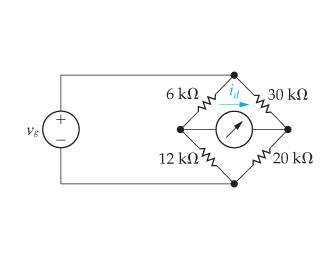

Find the detector current i_d in the unbalanced bridge in the figure if the voltage drop across the detector is negligible. The source voltage v_g is 180V.
I am not sure what to do, or even how to find the equivalent resistance. I have learned the delta-y transformation, but I don't suspect that will help me here, since the detector has negligible resistance, right? (and if it doesn't have negligible resistance, than the current is negligible, if i am understanding V=IR correctly)
Someone to point me in the right direction would be greatly appreciated.
If thevoltage drop across the detector is zero, are you entitled to run a wire across it?
no but the question is asking for the current there. or at least that's how i interpret the question... i am somewhat new to this but the diagram clearly has a wire going across and it seems to be asking for the current there.
if there was no wire it would be a simple matter of series/parallel

It's not a wire, it's a detector, but you are still right. You can think of it as a wire.
In which case you have only 1 dependent node, so now you can determine the currents thru all the resistors. Then write KCL equations (Ʃi = 0) at both ends of the wire to get the wire current.

Ok, well I must have missed something crucial. I have finished all the homework except for this question, using node voltage and mesh current analysis. This question looks comparatively simple, but it is simply not computing for me...
I assumed the wire was a node, and solved for the equivalent resistance. I got Req=(175/11)kΩ which makes the current running through the voltage source 11.314mA.
Then I used node-voltage analysis. V1 is the node connected to the positive terminal of the voltage source, the 6k, and the 30k resistors. V2 is the node connected to the negative terminal of the voltage source, the 12k and the 20k resistors. The reference node is the node in the middle.
Doing KCL for V1 (11.314mA going in, i1 and i2 going out), I got:
11.314E-3 = (V1/6k){this is i1} + (V1/30k){this is i2}
Doing KCL for V2 (all currents are flowing out of this node), I got:
11.314E-3 + (V2/12k){this is i4} + (V2/20k){this is i3} = 0
V1 = 56.57V
V2 = -84.855V
Using these, I could find each current:
i1 = 9.428mA
i2 = 1.886mA
i3 = -4.243mA
i4 = -7.071mA
Now doing a KCL on the reference tells me that between i1 and i3 there is 2.357mA going through the detector, but the software is telling me that this is incorrect. I only have more attempt so I want to be sure that I have the answer before I submit it.
Node-voltage and mesh current have made things much easier to understand for me, but this question is really giving me hell, and everyone else seems to think it's the easiest question..
Thanks for your help in advance.
Well, 1st thing you know is that V1 - V2 must = 180V & yours adds up to only 141.425V.
You did not get the total resistance across the voltage source right. The total current supplied by the voltage source is more than 11.314 mA.
But you have the right idea, computing i1 thru i4. Just do that over.
EDIT: Wow ok, idk how I ended up with 175/11 k for Req, but I just did the calculations again and came up with 12.5k.
SUPER EDIT: I see what I did. Instead of 12*20/(12+20), I did 12*20/(12+10). Wasn't taking my time...
Tell me what you got for i1 thru i4 and I'll tell you if it's what I got.

Ok.. I redid all the work with the new values and got the correct answer on my last attempt. Thank you very much for noticing that error. I can't believe that was the issue, I'm usually very careful, I promise!
Three suggestions for approaching the problem:
1. Assume the detector is a wire and use mesh current analysis to find the current in the wire (there are three loops).
2. Assume the detector has some resistance R and solve for the current expression using nodal analysis. Then take the limit as R goes to zero.
3. Treat the left and right sides of the bridge as separate voltage dividers driven by separate voltage sources Vg. Find Thevenin equivalents for both. Connect them output to output and determine the current that flows.
