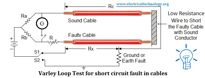

I am currently working on a module for the practical application of DC bridges. The particular problem I have at the minute involve "show that" questions.
The first question is in 3 parts and reads as follows: -
A Varley Bridge is connected to a faulty three core copper cable by two identical copper leads of resistance ##R_l##
(a)
Show for the initial reading (connection to earth) that;
##2R_x = 2R_c - R_i ##.....(1)
Where ##R_c## is the resistance of the cable core
##R_i## is the initial reading of the bridge
##R_x## is the cable resistance to the fault from the bridge
Then, for the final reading show that;
##2R_c = R_f - 2R_l##......(2)
Where ##R_l## is the lead resistance
and ##R_f## is the final reading resistance
Then by substituting (2) into (1) and re arranging the equation, show:
##R_x +R_l = \frac {R_f - R_i}{R_f}(R_c + R_l)##

First make a schema like this:

Hi, thanks for helping with this. I know that the reading on the Galvanometer needs to be zero so looking at the diagram above the variable resistance ##R_i , R_f## for reading 2 will play some part in the answer. My problem is trying to show that ##R_x +R_l = \frac {R_f - R_i}{R_f}(R_c + R_l)##
This is what's confusing me
You almost found it:
From equation 2*Rc=Rf−2RL you'll get (Rc+RL)/Rf=1/2
Find now Rx + RL
2*Rx=2*Rc-Ri ?
2*RL=Rf-2*Rc ?

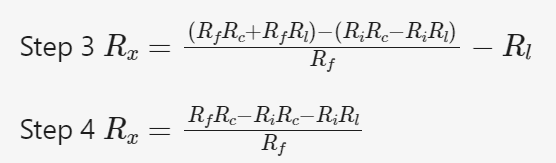

Step 1 ##R_x + R_l = \frac{(R_f R_c+R_f R_l) - (R_i R_c - R_i R_l)}{R_f}##
Step 2 ##R_x + R_l = \frac{(R_f R_c+R_f R_l) - (R_i R_c - R_i R_l)}{R_f}##
Step 3 ##R_x = \frac{(R_f R_c+R_f R_l) - (R_i R_c - R_i R_l)}{R_f}-R_l##
Step 4 ##R_x = \frac{R_f R_c - R_i R_c - R_i R_l}{R_f}##
Step 5 ##R_x = \frac{R_c(R_f - R_i)}{R_f} - \frac{R_i R_l}{R_f}##
I think this is correct, I would just like confirmation and if this is not correct please point out my mistake.

Hello,
I have also been tasked with this question for unit I am working towards. I can follow Davids calculations until step to step 5.
Would there be somebody who can explain how David has simplified Step 3 to obtain Step 4. Apologies my maths is not too strong but I am working on it. I don't expect an answer but if somebody could point me in a method I could research.
Thanks Sam

Welcome to PF, Sam.
Convert that trailing stand-alone term to its equivalent divided by Rf so you can combine the fractions. Do you see how that cancels out one of the numerator terms in the left fraction?
berkeman said:
Welcome to PF, Sam.
Thank you so much for this! I must admit I am a little annoyed I didn't see this myself, I was just not visualizing it correctly.
