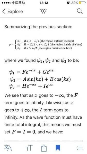

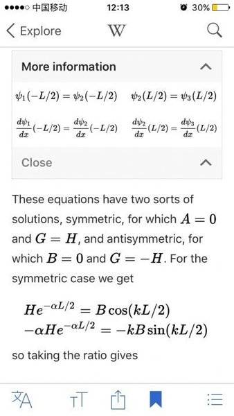

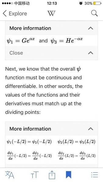

Some questions about the Finite Potential Well
Guaicai
Screenshot of a Wikipedia page on the finite potential well summarising piecewise wave functions: psi1 = Fe^(-alpha x) + Ge^(alpha x) outside the box, psi2 = A sin(kx) + B cos(kx) inside, and psi3 = He^(-alpha x) + Ie^(alpha x) for x > L/2, with the text concluding F = I = 0.
Phone screenshot of a Wikipedia article on the finite potential well showing wavefunction matching: psi1 = Ge^(alpha x) and psi3 = He^(-alpha x), with continuity conditions at x = -L/2 and x = L/2 for psi and its derivative.
Screenshot of a phone Wikipedia page showing matching conditions for the finite potential well: psi1(-L/2)=psi2(-L/2), psi2(L/2)=psi3(L/2), and derivative conditions, followed by text on symmetric and antisymmetric solutions with equations He^(-alpha L/2)=B cos(kL/2) and -alpha H e^(-alpha L/2)=-kB sin(kL/2).
How the symmetric and antisymmetric have results: A=0,G=H and B=0,G=-H in last picture ?[emoji53]
Take a pencil and a paper then try drawing the symmetric one first where you have to substitute A=0, G=H into ##\psi_1##, ##\psi_2##, and ##\psi_3##. How does the resulting curve looks like if you make the ##x=0## line as a symmetrical line? Do the same for antisymmetric solution.
