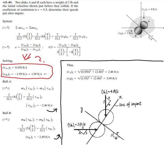

Hi guys, thanks for the warm welcome and quick replies. Here's the question and it's solution. I was trying to figure it out (how they solve it) and I could not understand how they found the 2 variables in the red box (see image attached below). Thanks again.

(v_A)2 is the final velocity of body A, i.e., its velocity after the collision
(v_A)_2x is the x-component of body A's final velocity after collision
(v_(Ax))_2 is the after collision value of A's x-component of velocity
The sum of the x-components of momentum of the system before and after the bodies collide remains constant. The same goes for the y-components of momentum.

(vA)2x and (vAx)2 are the same
(i've no idea why they've done that :redface:)
so they just add (vA)2x + (vB)2x to (vA)2x - (vB)2x to get 2(vA)2x
(and subtract to get 2(vB)2x) :wink:
Could someone please solve for one of them (with steps)? I still don't understand how they solve for those variables. If they are indeed identical, why can't I substitute one set into the other formula? I get completely incorrect values.
