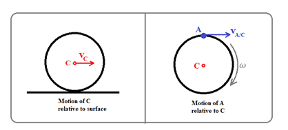

##\vec v_A = \vec v_C + \vec v_{A/C}## where ##\vec v_A## and ##\vec v_C## are the velocities of ##A## and ##C## with respect to the "lab frame" (i.e., with respect to the fixed surface on which the cylinder is rolling). The two velocities on the right-hand side of the equation are illustrated below
The left figure shows the velocity of ##C## relative to the lab.
The figure on the right shows the velocity of ##A## relative to ##C##. In this figure, ##C## is at rest while the cylinder rotates around ##C## with angular speed ##\omega##.
You should be able to express both ##v_C## and ##v_{A/C}## in terms of ##\omega## and the radius of the cylinder, ##r##.

So I would end up with ##\vec v_A=2v_C=2\omega r##? Is it correct the way I understand why ##\vec v_A = \vec v_C + \vec v_{A/C}##?

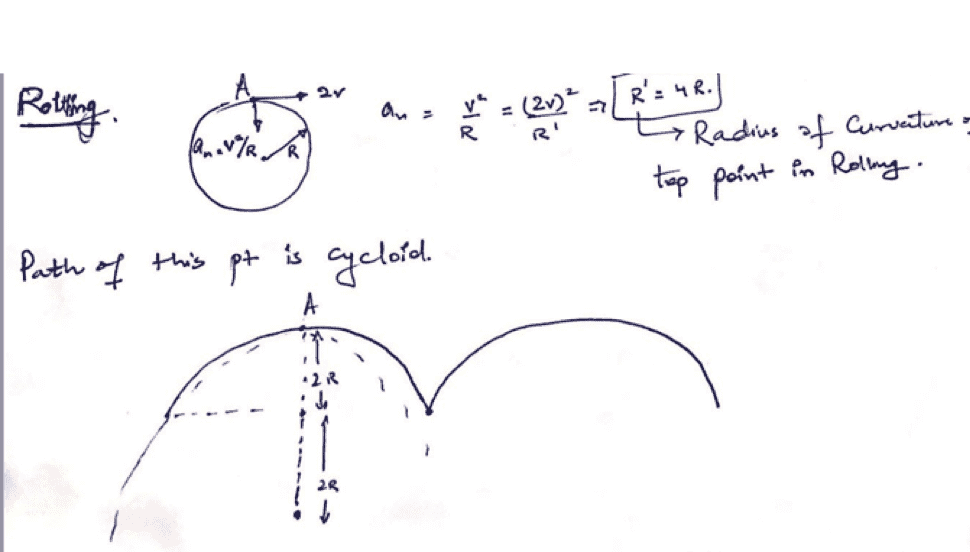

  • #74
Please see the below image for solution...

Point A is rotating about centre of mass with angular velocity w and also translating with velocity v. So net velocity of top point is v + wR and since v=wR. So Vnet = 2v = 2wR

Lowest point on body is not slipping with respect to the point in contact on ground means there relative velocity is zero. Velocity of lowest point on body is v-wR and that on ground is zero. So, v-wR=0
