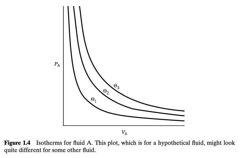

For the systems we are considering, we know from experiment that pressure and volume are independent thermodynamic variables and that the intensive state of each system is individually is completely described by just these two variables. That is, if equilibrium is reached at a certain pressure and volume, all the macroscopic properties have certain characteristic values.
Next, we think about what happens when we impose an additional constraint on a system, say A, namely that it is in thermal equilibrium with system C that is in a specified state. What happens is that we no longer have two independent variables, but only one: pressure or volume.
For a given value of pressure ##P_A## there is only one volume ##V_A## at which there will be thermal equilibrium with C. If we plot ##P_A## against ##V_A## the resulting curve is called an isotherm.
When we change the state of C we get a different isotherm.
We label each isotherm with something we denote ##\Phi## and that we call temperature.
Here is the point where I start to have doubts.
The book says
Figure 1.4 illustrates Boyle’s law, which states that ##PV=## constant for a specified amount of gas at a specified temperature. Experimentally, this is strictly true only in the limit of zero pressure.
I don't understand this notion about zero pressure.
If pressure is zero, then the lefthand side is zero, so the righthand side must be zero as well, right?

One aspect I noticed is that the keyword is limit.
Boyle's law says that ##PV=## constant for a specified amount of gas at a specified temperature when we consider the limit of zero pressure. P and V are not independent in this limit: V must approach infinity.
This doesn't get me very much additional understanding however.
Do you know how limits work in math? It is exactly the same line of thinking.
I do know how limits work. In the limit where pressure approaches zero, what happens to volume?
The statement refers to the behavior of the temperature scale. The limit assumes the volume to be fixed when the limit is considered (this is a thought exercise). It is a definition.
How can the limit of ##PV## as ##P## approaches zero with ##V## fixed be constant?
PV is constant for a fixed temperature for a given system.

The original reasoning started with isotherms, ie a relationship between two independent variables P and V along a curve on which PV is constant. What does it mean to say that this relationship is strictly true in the limit where, as I understand it, pressure is fixed at zero?
The limit is the value as P approaches zero. Take the isotherm and extrapolate it smoothly to zero P. Obviously if you are on a curve P and V are not independent.
"Take the isotherm and extrapolate it smoothly to zero P."
No idea what this means.
Do you have an isotherm graph of P vs V?
