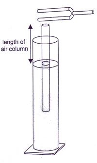

A student carries out an experiment to measure the speed of sound in air and its temperature. He uses the equipment shown at the right. The student measures the length of the air column when resonance is produced in the tube by the tuning fork.
Her results are listed below:
Frequency of Tuning Fork = 625Hz
Length of Air Column = 136mm = 0.136m
Temperature = ?
Diagram of a tuning fork held above a tall glass cylinder of water with a open-ended tube inserted into it, with a double-headed arrow marking the length of the air column between the tube's top and the water surface.
a) At what length of pipe raised out of the water would the student obtain a second resonant point?
b) From the student’s results, what is the speed of sound in air and the surrounding temperature?
(Ignore end correction factors)
Can't answer that unless we know that the given length is for the first resonant point.

I thought the 625Hz, 136mm was for the first resonant point, so λ=4L=544mm.
Dear PS,
Your second resonant calculation keeps L fixed and finds ##\lambda##. But the instruction asks for the second L with the same ##\lambda##. First L was at ##\lambda/4##, so second L will be at three times that.

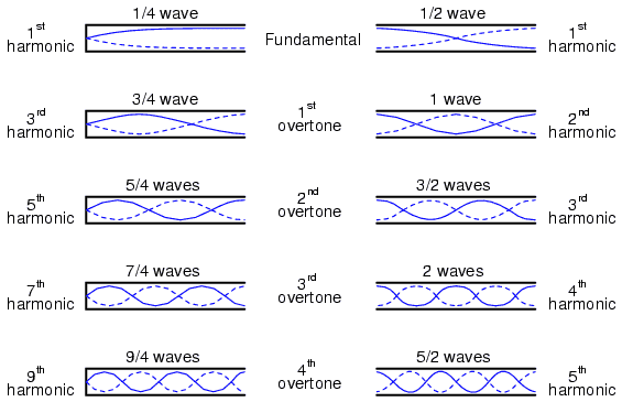

I thought that the formula that I used first in part A would take the available length of the pipe L = 0.136m and work out the length of it required to get a full wavelength. I then worked out 3/4 of a wavelength to find the length of pipe extended out of the water to get the third harmonic (I'm assuming nodes are resonant points, therefore the third harmonic of a closed pipe has 2 nodes, which like I said I think are resonant points).
If this is wrong please correct me. Like I said this is an area of physics that I am not an expert on. I know that there is/are error/s in my solution because when solving for the temperature it is -261 degrees Celsius which is way off from anything that could be considered reasonable. I'm thinking I have used the formulas incorrectly.
Diagram of standing waves in a closed pipe showing harmonics from the fundamental to the 5th harmonic, with 1/4, 1/2, 3/4, 1, 5/4, 3/2, 7/4, 2, 9/4 and 5/2 waves in each tube, labelled by harmonic and overtone.
So full wavelenth is 0.544 m, right. That's settled then. Doesn't change anymore unless the speed of sound changes. If you then work out 3/4 of that to find the length of pipe extended out of the water to get the resonance corresponding to 3/4 ##\lambda##, that gives 3/4 ##\lambda ## = 0.408 m.
You confuse yourself bringing in the term third harmonic. For the tuning fork that would be 1875 Hz and you can bet that it's almost absent. For the pipe it so happens that it will also resonate (frequency-wise the pipe resonates at its second resonance: n = 2, L = 3/4 ##\lambda_{1825\;Hz}## in your formula) at this frequency, but it would be as good as unnoticeable (because of the dominance of the 1st resonance at 625 Hz).
Situation changes when the pipe is pulled out further: the second resonance (for the pipe) with the 625 Hz ground tone of the tuning fork has no competitors worth mentioning.
By the way: no tuning fork at hand do actually do the experiment ? Or a tone generator with a speaker ?
[edit] Finally, I suspect the pictures distract you from the actual exercise too: imagine the second picture on the left, stretched in the horizontal direction by a factor of 3. That's what we are talking about: the second resonance for the pipe with this ##\lambda## that gave a first resonance at L = 0.136 m. Teaser: can you tell at what frequency such a long pipe would resonate for the first time
