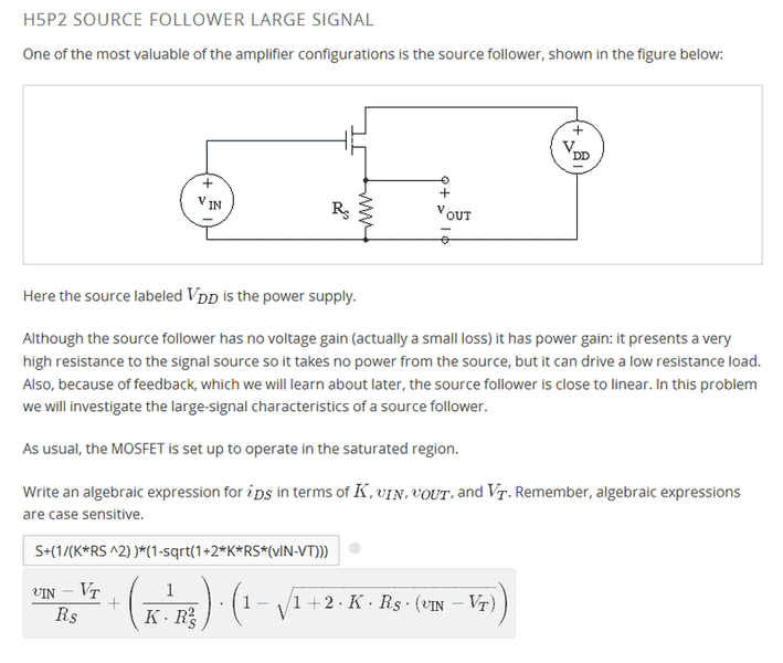

I'm still not very confident in analyzing circuits. Here's what I know:
1) v_o=v_IN - v_T
2) id=k/2*(v_IN-v_T)^2
3) v_o=v_S-(k/2)(v_IN-v_T)^2*RS
4) v_o = v_S-id*Rs
iDS = v_o/RS
The answer I chose in the photo was based off of other online discussions. I'm very confused and don't have the slightest idea as to where to go. Any ideas appreciated.

Equations 3 and 4 are wrong. Note that Vo and Vs are the same voltage!
I would look carefully at eq. 2 ...

Oh, BTW your answer is correct also. But for the given circuit, you don't know Vo.
