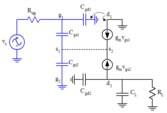

I've found the gain, but now I need to estimate the upper cutoff frequency with the open circuit time constant method, so the upper 3dB cutoff would roughly be $$\sum_{i = 1}^{n} \frac{1}{\tau_i}$$
The attempt at a solution
I'm currently trying to make sense of the given solutions:
Hand-drawn small-signal circuit of a two-stage MOSFET amplifier showing Rsig, Vs, Cgd1, Cgs1, Cgs2, Cgd2, gm Vgs1, gm Vgs2, CL and RL, with gate, source, drain and x nodes labelled.
Handwritten note: Both Q1 and Q2 are identical, operating at the same bias currents, so we can conclude that vgs1 = -vgs2 and the line between x-x can be eliminated. This reduces the circuit to the diagram shown, with gm vgs1 source, Cgd2, C2 and R_L.
I got something similar to the first picture after drawing out the small signal equivalent, but I'm completely lost as to how they went from that circuit to the one in the second picture. Why does the drain of Q2 suddenly become grounded, and how did the GS capacitors combine and turn into half of their original value? I've tried searching around but haven't found any explanations of the simplification method used here.
I attempted to use a 1v test voltage at the gate source capacitors (in the first circuit) to find the equivalent resistance seen by them but that yielded a different answer to what I get if I work it out via the second circuit.
Any help/tips would be greatly appreciated, thanks.
It might help to split apart (graphically) some of the ground connection in order to visually isolate in the input and output portions of the circuit. So starting with their first picture and breaking up the ground connections at the drain of Q1 and the gate of Q2:

Ah ok, so the equivalent capacitances (and the voltages across them) combine and since Vgs2=-Vgs1, the current sources are equivalent and one can be removed? So whenever there's a wire connecting two portions of a node like this, can you always just remove it and proceed to simplify the circuit? I guess I'm slightly confused as to what happens to the s1-s2 wire and in what situations I can effectively remove it.
More precisely, one is redundant since they are both producing the same current in the same direction.
Usually the argument goes that if two nodes are at the same potential then connecting them with a wire will make no change in circuit operation (as no current will flow through that wire and no potentials will change as a result). Here there's an existing wire and the argument is reversed: removing the wire will not change the potentials at the nodes since Vgs1 = Vgs2.

Thanks that clears up a lot, strange that I never specifically heard about this in any of my introductory circuit courses but it makes sense now.
You may have seen it used when simplifying highly symmetric resistance or capacitance networks. It's often seen as a simplification "trick" in puzzle or challenge type questions.
