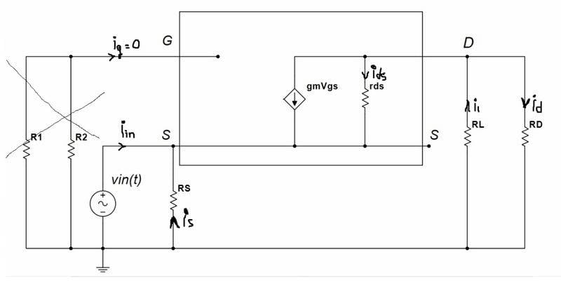

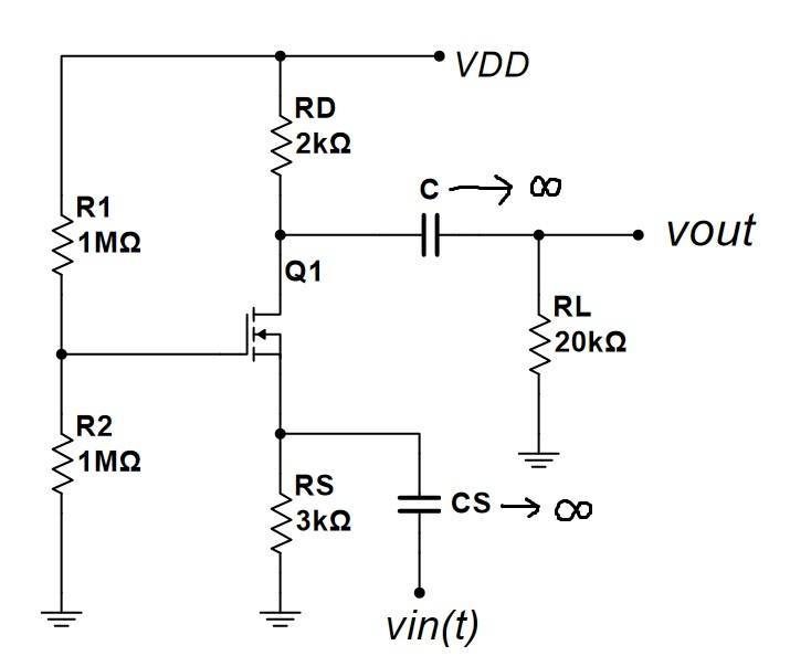

My task is to calculate input resistance for circuit below:
VDD=10V, Vtn=1V, β=1mA/V^2, VA=100V, load resistance RL=20k.
Here is model for AC analysis (DC source and infinite capacitances are short circuits, current directions chosen arbitrarily):
After calculationg input current iin, I found input resistance Rin=vin/iin=1/((1/RL+1/RD)*(1/rds+gm)/(1/RL+1/RD+1/rds)+1/Rs).
Here is solution from my book: Rin=(rds+RD)*RS/(rds+RD+(1+gm*rds)*RS). I double checked my result and it's correct.I simulated circuit in Multisim and value for input resistance I got matches with value I got by hand. What's wrong? Any idea? :)
We can see in solution from book there is no RL included in input resistance. If I remove RL from my model and analyse that circuit then I got result from book but question is, why should I remove RL?
Because they asked for input RESISTANCE. The infinite decoupling capacitor to R_L gets rid of R_L in the gain calculation. Had they asked for input IMPEDANCE you would have been right.

You need to have "input resistance" better defined for you. Are you sure they didn't mean "real part of input impedance"? In which case you'd be right, R_L would have to be included. And so would any resistance in series with the input.
So either they mean 'resistance' in which case Rin = infinity with or without any added resistance, or they mean 'real part of input impedance' in which case any input resistor would have to be added to the real part of input impedance.
Since they said both capacitors are infinite I think your original answer is correct (i.e. include R_L).

So we conclude that by "input resistance" they mean "real part of input impendance" and my original calculations are ok?

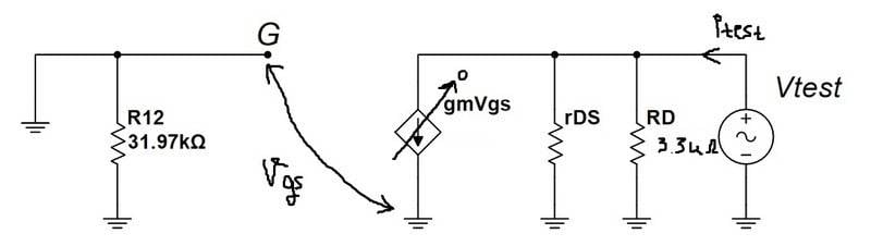

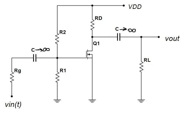

Here is another example from my book, now there is resistance in series with vin and Rout has to be found:
R1=100kΩ, R2=47kΩ, RD=3.3kΩ, VDD=5V, Vtn=1.2V, β=1mA/V^2, internal generator resistance Rg=1kΩ, load resistance RL=10kΩ, VA=50V.
Here is solution from book:
R12=R1*R2/(R1+R2)
Rout=Vtest/itest=rDS*RD/(rDS+RD)=3.203kΩ.
Here we can see that input voltage vin is shorted (it's ok, when calculating output (or input) resistance we short all independent voltage sources and remove independent current sources), capacitor acts like a short and internal source resistance is also shorted.
So according to these examples, general conclusion would be:
When calculating output resistance, (real part of output impendance), input voltage should be shorted altogether with it's internal resistance (if it has internal resistance), load resistance should be removed and in place it was we put test voltage, solve circuit and find Rout as vtest/itest.
Do you agree? :)

Well, I don't see the correspondence between the circuit and its equivalent circuit. At all! Different connections, different values, etc. ...
I agree with what you wrote though. I still think the word 'resistance' is misplaced, but if 'real part of impedance' is understood then that's fine.
If the input is via the gate, remember that the input impedance at the gate is infinite. So it doesn't matter if there is input resistance in series with the input, the gate is always at zero potential. Nice thing about MOSFETs!
It was my fault, I draw it wrong! I will correct it.

The subject under discussion in this thread is the capacitor-coupled amplifier. An unqualified statement relating to input resistance is synonymous with midband input impedance. Always.
I'm not dismissing your examples; in appropriate threads they may be helpful. But in this amplifier thread a tale about a passive circuit is at best tangential.
I wouldn't even put it that way. The unqualified term "input resistance" when applied to general amplifiers can be taken as meaning the input resistance where all capacitors are doing what is intended.[/color]
That is, conditions where coupling capacitors are coupling to perfection, bypass-capacitors are bypassing dazzlingly well, and any frequency-response shaping capacitors are shaping up spectacularly to their appointed task. These conditions are often referred to as the midband, so you have terms such as midband gain, and midband input and output resistance/impedance, etc. (It is not the same as considering the components to be ideal.)
