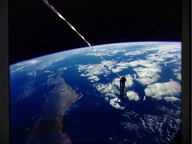

For smaller space stations(ships) you might consider using a tether to generate centripetal acceleration. A crew module attached to the engine section by a 1-10 km cable rotating around center of mass would look quite spectacular I think.
Gemini 11-12 artificial gravity experiments:
