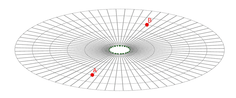

@cianfa is asking about the extremal spacelike curve that lies in a given spacelike hypersurface containing the two events. That’s not the same thing as the spacelike geodesic between the two events (although it may be more useful if the hypersurface was chosen to correspond to some interesting/relevant simultaneity convention).
Why not take the hypersurface with its induced metric and coordinates and simply extremize the distance between two points lying on it?
cianfa72 said:
Summary:: How to define the spacetime 'distance' between events belonging to a spacelike hypersurface
How is defined in this case the maximum (or minimum ?) spacetime 'distance' between a couple of events belonging to it ?
By doing what I said, you will find that the curve is a spacelike geodesic. However it may not be a geodesic in the full space (i.e., spacetime).

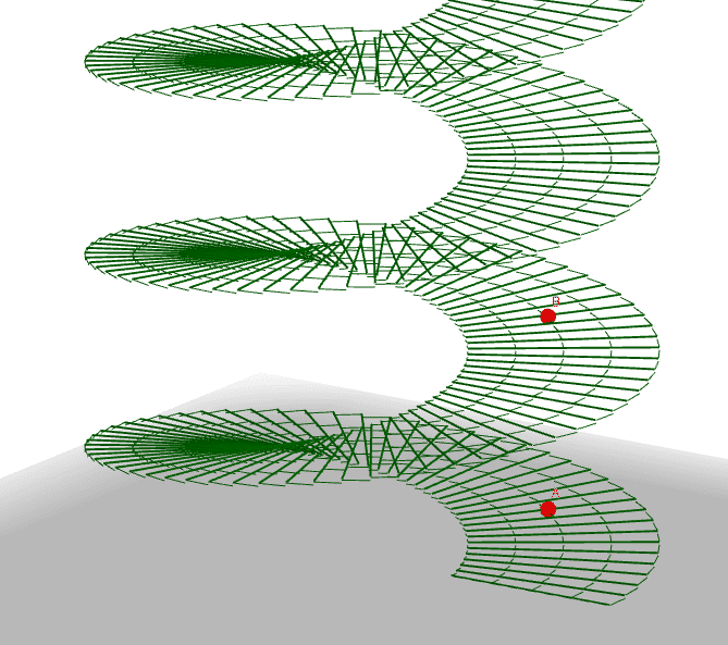

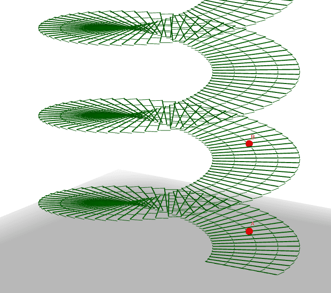

Just a comment:
one probably needs to be specific about restrictions or conditions.
Here are two events on a spacelike surface that are timelike-related.
Green wireframe surface forming a helical, wave-like ribbon above a grey plane, with two red dots labelled A (lower) and B (upper) on the ribbon.
You can exclude events on this spacelike surface that causally-related to the lower-event A
by drawing the boundary and interior of the light-cone of A and excluding events in the intersection.

I assumed the OP meant a geodesic within the hypersurface, with induced metric (though they didn't necessarily know the terminology or techniques). In that case, there is nothing to exclude - there is a spacelike spiral geodesic of the induced metric between your two points.
[strike]Yes, there is a geodesic on the spacelike surface I gave.[/strike]
hmmm... I’m not so sure now.

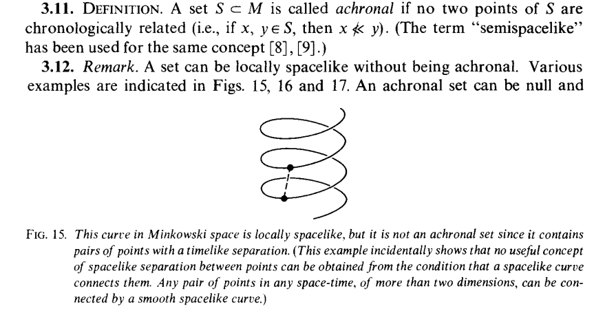

two events on a spacelike surface are not necessarily spacelike-related
Yes, this is something a lot of people don't stop to think about when they think about spacelike surfaces.
The technically correct term for a surface such that any two points of the surface are spacelike separated from each other is, IIRC, "acausal".

since two events on a spacelike surface are not necessarily spacelike-related.
Ah that was my incorrect understanding !
ok good point, I was not aware about this definition.

What about instead the following definition of spacelike hypersurface: a 3-dimensional hypersurface such that at each point (event) the normal vector (in the attached tangent space of course) is timelike ?
The helical spacelike surface @robphy described satisfies this definition.
vanhees71 said:
if you already have a spacelike hypersurface, there's no problem since this defines a hypersurface of simultaneity
No, it doesn't. The helical spacelike surface that @robphy described is a counterexample. A hypersurface of simultaneity must be acausal, which is a much stronger condition than just being a spacelike hypersurface.
