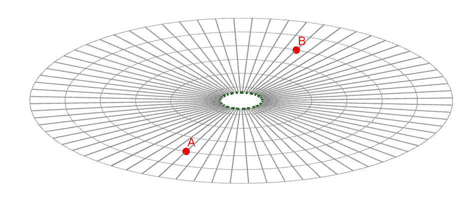

In the punctured plane [here, an acausal surface in Minkowski spacetime],
is there a [spacelike] geodesic from A to B?
robphy said:
the punctured plane
I'm not sure this is a valid manifold, since it will include a boundary around the hole in the center and no coordinate chart is possible that can cover the boundary points.
A plane punctured by a single point would be a valid manifold since the single point left out does not preclude having a valid coordinate chart.

Is an infinite-plane with a point removed
topologically equivalent to an infinite-plane with a disk and its disk-boundary removed?
robphy said:
Is there a restriction to use a single coordinate chart?
It's not a question of having to use a single coordinate chart; it's perfectly acceptable to have a manifold that can only be covered by an atlas of multiple charts. (All of the sphere manifolds are examples.)
The problem with the "punctured plane" with a finite sized hole is that there is no valid coordinate chart that can cover the boundary points, if those points need to be included in the manifold. Although now that I come to think of it, I suppose one could consider the manifold itself to not include the boundary points, but only to approach them as a limit. That would make it a valid manifold.
Yes, I think so. See my "although" above.
Ok, but that is a surface with a removable singularity, in the standard GR definition of geodesic incompleteness. Thus, one would need to add nonsingular spacelike hypersurface to guarantee that you you could connect any two points by a geodesic of the induced metric. Of course, this is a case of victory by definition, because if you can’t the surface is ipso facto singular by the GR definition.
In fact, I was wondering whether the spiral hypersurface could be extended to avoid geodesic incompleteness, but I couldn’t decide one way or the other by analysis that I could come up with.
