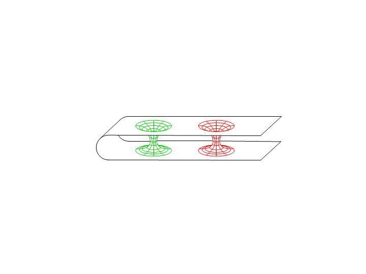

Is the "no tear" idea related to the idea that if you foliate spacetime into a series of spacelike surfaces, the topology should never change from one surface to another?
Good question JesseM
My first thought was: yes, I think I am saying that in classical relativity I thought the topology should be constant on each spacelike hypersurface from minus to plus timelike infinity. In which case, part of the question is "what's the proper way of describing such topological invariance in the language of GR?" Which rule(s) say(s) you can/can't do this?
But then I thought: I'm not sure whether the topology is the problem. I have a vague recollection that there is a certain type of manifold surgery that can change the topology, and thus the question is - is that sort of thing allowed in GR? If (not), why (not)?
The problem is, IIRC, it is (mathematically) possible to shrink one hole down to nothing and at the moment of disappearance to create another infinitesimally small hole somewhere else. The topology is unchanged but the holes are in different places. Well, that's part of the problem: another part is that usually manifolds have distances rather than specific locations, but spacetime does (it has "events", if not utterly empty).
The attachment shows a red and a green wormhole with the standard embedding. The question is can you turn red <-> green without changing distances. I don't think that can be done in GR but I don't have a sound basis for that judgement.
