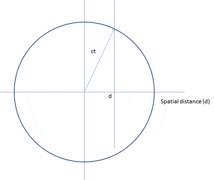

No, it is just moving the radius of the sphere (ct) to the same side as the squares of the spatial distances.
I still don't get your point. I have drawn a circle with radius ct and a spatial distance I called d. but then what is next? what do you mean by 'moving the radius of the sphere (ct) to the same side as the squares' ? and how does that lead to the conclusion of the minus sign.
Try Bondi, as I suggested in #21.
The “minus sign” shows up in the last step (if you want to take that step).
Nugatory said:
Better is to start working through a suitable textbook, and use the forum to help you when you’re stuck at a particular hard spot.
perhaps better indeed. However I already read the part about lorenz transformation and a lot of stuff about the basic principles of light several times at different places and a lot of video's about that also and that was exactly the hard spot to get clear where the minus sign comes from. So for me easy to accept that the speed of light is constant in all frames so that is not the point.
HansH said:
I still don't get your point. I have drawn a circle with radius ct and a spatial distance I called d. but then what is next? what do you mean by 'moving the radius of the sphere (ct) to the same side as the squares' ? and how does that lead to the conclusion of the minus sign. View attachment 305666
The equation of the circle of radius ##c \Delta t## is ##(c \Delta t)^2 = \Delta x^2 + \Delta y^2 + \Delta z^2##. Subtract ##(c\Delta t)^2## from both sides and you get
0 = -(c\Delta t)^2 + \Delta x^2 + \Delta y^2 + \Delta z^2.
The right hand side is just ##\Delta s^2##, which is invariant in Minkowski space.
