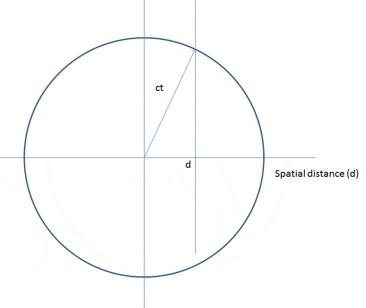

Therefore starting from scratch I tried to understand it starting from the speed of light being constant and the comparison between 2 reference frames with constant speed difference.
Then I could immediately see that pythagoras holds making the square of the distance (dx^2+dy^2+dz^2) + ds^2=(cdt)^2 where ds^2 is the distance that the light moves in 1 second as seen by each observer in its own reference frame. But the observer looking to the other reference frame sees the light passing over a longer distance therefore the light seems to go slower from his perspective.
so it this where it comes from?

That part is easy. If the speed of light is invariant then the formula for a light cone is invariant: $$-(c\Delta t)^2+ \Delta x^2+\Delta y^2 + \Delta z^2=0$$ in other words all frames agree that the same set of events defines a sphere expanding at ##c##. So that is where the minus sign comes from. It is immediately required for the second postulate.
From there it is a small jump to simply guess that maybe this holds for values other than ##0## on the right hand. Then we can derive all of the testable statements of SR and see if our guess is right.
$$-(c\Delta t)^2+ \Delta x^2+\Delta y^2 + \Delta z^2=0$$, a sphere expanding at ##c##. is there some format error here? looks rather cryptical to me.

$$-(c\Delta t)^2+ \Delta x^2+\Delta y^2 + \Delta z^2=0$$ is there some format error here?
No. It's just the observation that for a light ray, the distance traveled divided by the time taken is ##c##. Use Pythagoras and rearrange to get the formula stated. It must then be invariant if the speed of light is invariant.
No, this is the standard formula for a sphere of radius ##c\Delta t##. Haven’t you seen the formula for a sphere?
yes that is pythagoras x^2+y^2+z^2=r^2 but what does $$ and ## mean and what is the relation between a sphere and the space time interval. I think i also here miss some thinking steps?

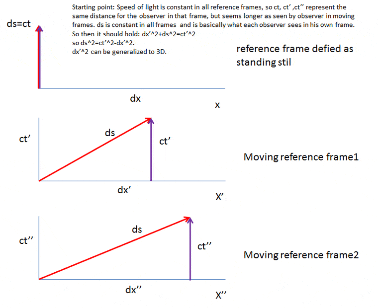

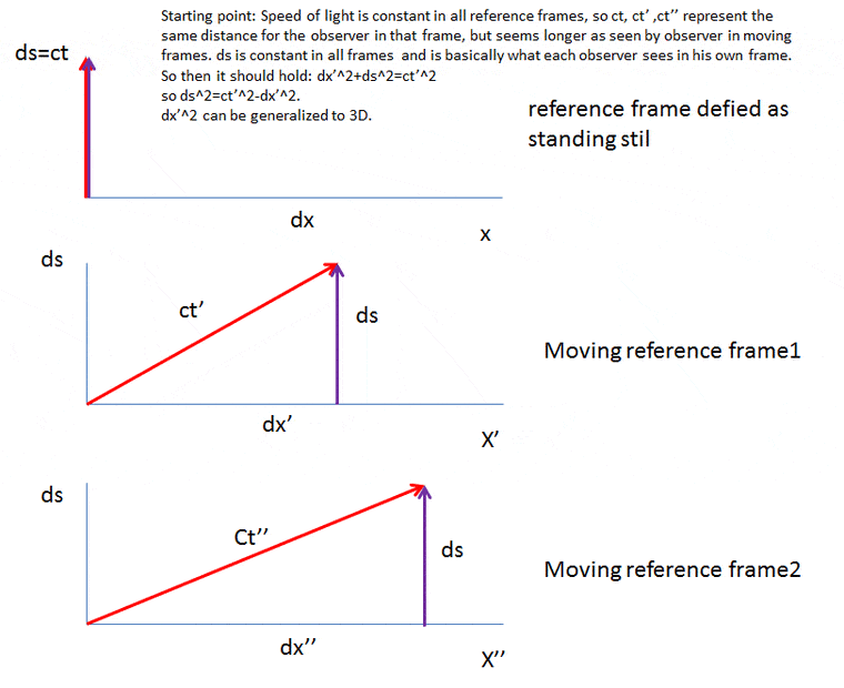

based on 'start with how things work ' I come to the logical sequence of understanding as follows:
Your line segments are labeled wrong in your "moving frame" diagrams. ##ds## is the invariant length of the line segment that is vertical in your first frame and the hypotenuse of the triangle in your moving frames. The vertical lines you have labeled as ##ds## in your moving frame diagrams should be labeled ##cdt'## and ##cdt''##.
you mean this? but then it would mean that according to pythagoras ds^2=dx^2+ct^2 which is a different equation. so then I am confused.

you mean this? but then it would mean that according to pythagoras ds^2=dx^2+ct^2 which is a different equation. so then I am confused. View attachment 305642
Pythagoras’ theorem is a theorem in Euclidean space. Spacetime is not Euclidean, it is Minkowski space. In Minkowski space, the equivalent of Pythagoras’ theorem is ##ds^2 = c^2 dt^2 - dx^2##.
