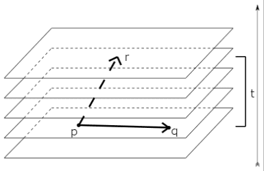

That's not true.malawi_glenn said:In Newtonian physics, time is not a coordinate, it is a parameter. Therefore the concept of "space-time" is not well defined.
That's what #115 is about.
"Space-time" actually starts with Galilean physics (actually Aristotelian Physics, which lacks the principle of relativity).
Look at
- Geroch (1978), General Relativity from A to B (Ch 2 The Aristotelian View; Ch 3 The Galilean View) https://www.amazon.com/dp/0226288641/?tag=pfamazon01-20
- Penrose (2004), The Road to Reality (Ch 17.1 The spacetime of Aristotelian physics; Ch 17.2 Spacetime for Galilean relativity ) https://www.amazon.com/dp/0679776311/?tag=pfamazon01-20
- Trautman (1964), "Comparison of Newtonian and Relativistic Theories of Space-Time", http://trautman.fuw.edu.pl/publications/Papers-in-pdf/22.pdf
- Cartan (1923) - https://en.wikipedia.org/wiki/Newton–Cartan_theory
