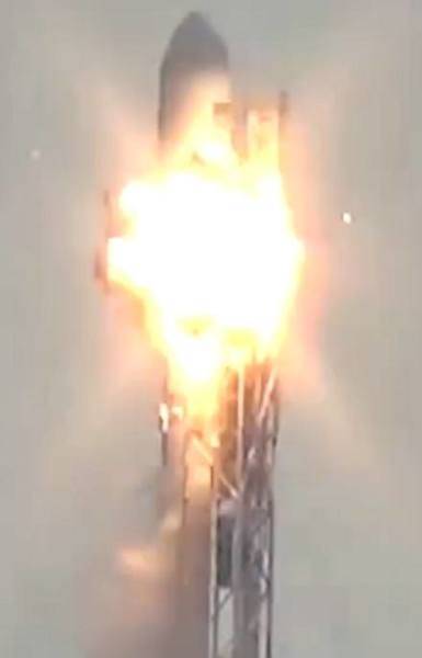

As already posted on PF, and you have likely seen in the news, a SpaceX rocket exploded, September 1, 2016. Elon Musk is reaching out for help in finding out how it happened. http://www.csmonitor.com/Science/20...calls-on-public-government-in-explosion-probe
I took the video and placed it in this, to allow frame-by-frame examination:
http://rowvid.com/?v=_BgJEXQkjNQ
Just in case... you can set the speed, for example, at .25 by clicking that button. Use the < and > buttons to move one frame at a time.
You will see, that at 71.7 (seconds) all appears ok.
The next frame, at 71.74, only 4/100 of a second later, the explosion is well under way. That is part of the problem for them, as it happened so quickly.
I already have my idea of what might have happened, and sent it along to reports@spaceX.com, but I want to let everyone else look for themselves to see if they can deduce anything. Some of the smart people at PF might be able to see something that the SpaceX people have not noticed.

With that said, you got the first frame of the explosion, or what I get, at least. But using rowvid.com is easy.
So, where do you think the explosion started?

Okay that was first frame at 71.74
Second frame at 71.78
Seems to me a kerosene leak would have run down and set the whole rocket afire, slowly like charcoal lighter. Clearly this was a kerosene & LOX mix burning,
Whole 2nd stage got engulfed in a fireball and blew apart.
Would've taken failure of both tanks to let fuel and LOX mix
so
My guess is 2nd stage engine somehow got a start signal .

Doing frame by frame, this is what I see:
50 to 71.73: Nothing of any significance.
71.77: In 40 msec or less, the "explosion" is already 17 feet high and wide. This is excluding illuminated sections of the booster that, on first glance, might appear to be part of the fire. Presuming that we started with a point source of ignition, this means that the illumination border has been moving at 8.5 feet in no more than 40msec or >210 feet per second or more.
71.81: In the next 40msec, the flames have continued to expand laterally, but the bottom of the flame has actually shortened! Moreover, a "cloud" created from cold temperatures along the bottom half of the booster is left undisturbed during this time - and for at least 10 frames that follow.
So at first, it would seem that what we are seeing in these first two frames is purely a flame propagation front. It would seem that an invisible and combustible mixture of gases was already there, hanging as a cloud in the air, when it became ignited.
But there's a problem. Flame propagation rates are measured in cm/sec, with our 210 feet per second being over 5300 cm/sec. Among the fastest propagation rates in air is a 38% mixture of hydrogen which tops out at roughly 480 cm/sec (http://www.comtherm.co.uk/CT-7a%20Fig.pdf). So, unsurprisingly, we are definitely working with something more potent than air.
Perhaps the chemists among us can come up with a mixture that will propagate at 6400 cm/sec. For comparison, the source above rates methane/air at about 70 cm/sec while this http://www.sciencedirect.com/science/article/pii/S0360544212005579 shows a oxy-methane mixture at about 295 cm/sec. Even assuming that hydrogen gets the same boost (haven't found a source on that), it would still fall short of our 6400 cm/sec. Besides, our gases should be on the cold side - slowing the burn rate down a bit.
So did something, perhaps turbulence or heat, enhanced the flame speed? Or perhaps the flame spread without incandescing for a few frames before becoming visible?
The flame propagation theory seems to have a problem.

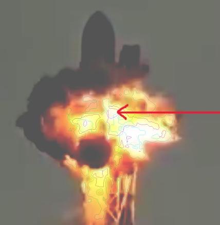

Here is what it looks like with the intensity range restricted so the bottom half of the intensity range is compressed.
The contour lines are brightness/color contours.

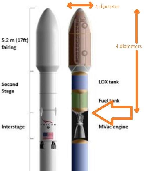

After viewing the video forward, backward, and stop-frame, the ignition point appears to coincide with the crescent shaped area at the arrow head. This is partially supported by a subtle color change within the crescent area (less Blue).
Visually, from the video, the initial flame front seems to travel toward the 7 o'clock position but rapidly changes to about the 5 o'clock position. Based on the above image, the origin is 3 to 3.1 nose cone diameters from the the nose cone tip at the right edge of the rocket.
Viewing the video backwards, the fireball seems to converge to a point 3.3 diameters from the tip, at the center of the rocket body.

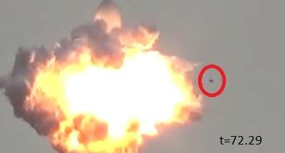

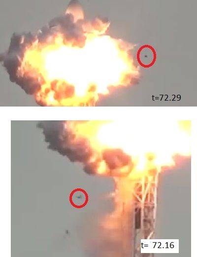

Jim, that is not a piece flying away. Go to 71.94 and look at the point at the bottom left hand corner, and then click until about 72.54. You will see the point go to the top right corner. I think that is a jet taking off from a nearby airport.
I think "fast fire" is misleading. I agree it's not detonation (that is, not as from high explosive), but rather subsonic (as for low explosive), but that's still an explosion, and yes it was clear that small bits were flying off.
I like the way the sound has been resynchronized on the Scott Manley commentary - that really helps convey what is happening.
I think it's interesting that although the initial flash of flame and smoke expands rapidly, the expansion is in a sideways direction and the rate of expansion seems to be rapidly decelerating. Also, the explosion is surprisingly symmetrical between left and right given that it seems to start on the right of the 2nd stage, although the left side of the expanding cloud appears to be darker (perhaps more fuel than oxidiser?). These factors suggest to me that the origin of the force which ejected the material was inside the second stage, and that the material then caught fire and exploded after it was ejected. That then suggests a failure of the helium pressure vessel, although presumably a more abrupt and total failure than in the previous case where a strut broke.
Edit: When I say "small bits" I'm referring for example to the bright point in the first frame just to the right of the strongback, not to the fast-moving dark specks which I assume are something small close to the camera.
There is a piece of the rocket going upwards, on the other hand, first visible at http://rowvid.com/?v=_BgJEXQkjNQ&t=72.1&s=1 and then in multiple images afterwards. It seems to be a rotating flat piece (it is not visible in some frames), with some flames visible beginning 72.58.
On that sort of time scale? I think it's a bug flying past the camera.
Jonathon, yes, that probably is a bug, but it is not debris from the explosion.

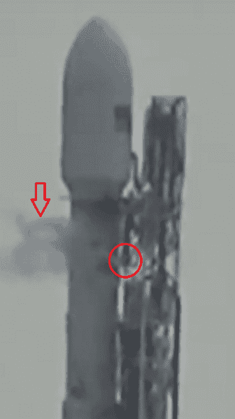

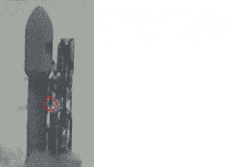

Here is a blinking of the explosion in an attempt to locate where the first blast occurred. I used the last frame, before the fire, and the first frame of the fire.
I made a better video:
Original:
Use replay to repeat it.
Is it possible the fault occurred at another location, but the explosion occurs because that is the only area susceptible to exploding?
