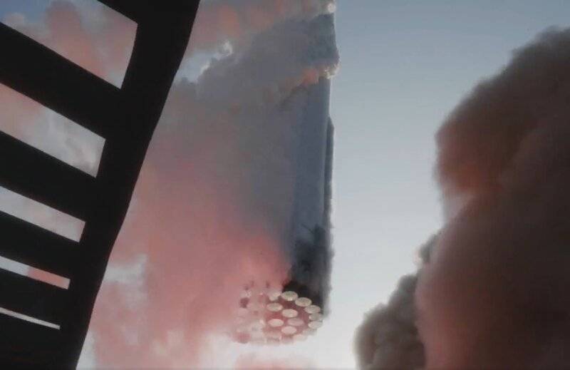

  • #41
31 engines, good enough for an orbital launch. One engine was stopped before ignition by the operators, one shut down automatically. Ship is still standing, no obvious damage to the launch pad either. For the bottom of the launch mount this test was worse than the actual launch because there the rocket will move away from it.
Likely ~70 MN, far more thrust than any other rocket. Saturn V had just 33 MN, SLS has 39 MN, N1 had 45 MN.
SpaceX and the FAA will need to go through the data, but assuming everything looks fine Starship passed its last major test before an orbital launch.

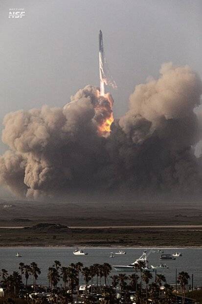

  • #60
Still aiming for an April 20 launch.
The FAA has released a 120 page document discussing environmental impact findings for this flight and the next two. If you ever wanted to know the size of the area around the Starship impact where a Hawaiian Monk Seal could get temporary hearing loss and how many of them we expect closer than that on average: You'll find that in the document (41.37 km2 and 0.001241 animals, page 14). Even if we add up all the animals in the list then we still expect not a single temporary hearing loss as most likely outcome, but it's great that millions have been spent determining all these numbers, which also included giving some of these animals hearing loss in the lab to find the pressure thresholds used as inputs.
We can learn more about the flight plan as a side effect of all these calculations: The ship will hit the water at terminal velocity, no chance of a landing burn. The impact is expected to mix methane and oxygen, leading to an explosion with a yield of a bit over 1 tonne of TNT. The booster will do a landing burn and is expected to survive impact, it should sink after water enters through open valves. If not they might use it as military target - shoot it until it sinks.
SpaceX plans a second and third flight with a similar flight profile, but the upper stages will not have a heat shield so they won't survive re-entry. The nominal booster landing is again in the ocean, but with some option to attempt a chopstick capture on the launch pad.
It's likely SpaceX will cancel the remaining missions if they don't think they can improve on them, e.g. if they reach orbit with the first or second flight and don't think they are ready for booster recovery yet. The hardware for the first three flights is at least half a year old, what they are building now (nominally: for a fourth flight) must have hundreds of improvements.
