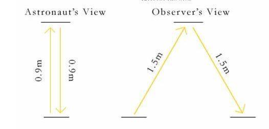

I disagree. The cause of time dilation in SR is very simple and can be shown with a simple diagram.
Here's one of hundreds that are available on the internet. This shouldn't even need any explanation.
This may be a little too simple. What is moving along the arrows? Are you trying to show a light clock?
This is the classic example of an astranaut in a space-ship shining a light perpendicular to the motion of the ship to a mirror on the floor and having it go down and come back up in a straight line. But to an observer for whom the ship is moving, the light beam is taking a "V" path, which has to be longer and since the speed of light can't be different only the time can be different, thus time dilation.
In other words, it's a light clock.

Maxila said:
This was meant to illustrate to phinds, that the diagram showing a longer light path as an explanation of time dilation, is not applicable to a case where the relative velocity between observers and the light path are all on the same vector.
Yes. The illustration only works for the situation where the relative velocity is perpendicular to the light path in the frame where the clock is at rest. Since you can always posit a clock in such an orientation the result is general even if the illustration is not.
Ah, I see. Yes, you're right, phinds' diagram doesn't cover that case. However, if you analyze that case, under the assumption that the speed of light is constant, it also turns out to show time dilation in the amount predicted by the SR formula. In fact, it's instructive to put both light beams (parallel and perpendicular to the direction of motion) in the same scenario, and verify that, if the distances in both directions are the same in the rest frame of the clock, so the two beams coincide on their return, they will also coincide on their return when viewed in a frame in which the clock is moving (parallel to one beam path and perpendicular to the other).
