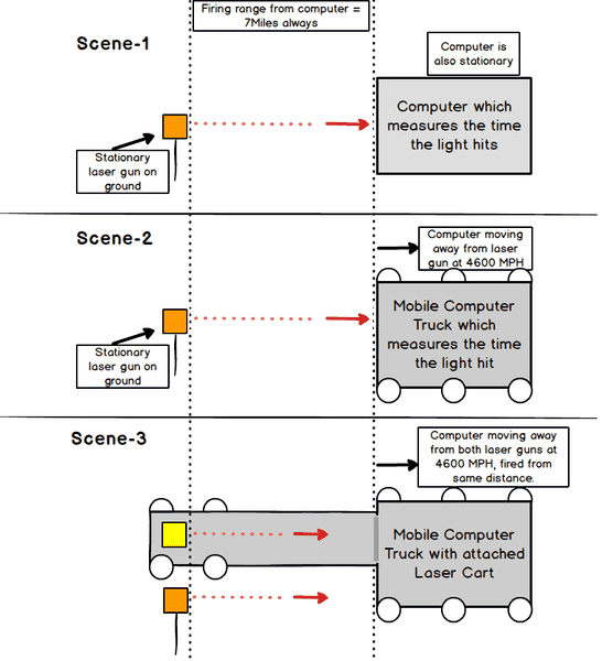

Having reviewed your scene 3, it appears to be this:
You have a laser on the ground at x=0 and a target on the ground at x=5 (measuring distance in light seconds), using rulers attached to the ground.
You also have a cart on a track also with a laser and a target. I am not clear how long this cart is - is it 5 light seconds as measured by rulers on the ground, or rulers on the cart?
The cart moves past the ground setup. When the lasers are next to each other, they fire. Which target is hit when? The answer depends on the answer to the question in my previous paragraph. If you can answer that then we can solve this.

Yes! That is exactly the setup
Wont they be the same thing? they are both 5 light seconds long.
The lasers both start to fire at the same distance away. And they both fire at the same Computer which is 5 light seconds away.
The only difference is, One lasergun is stationary on the ground, while the other is actually ON the truck.
What happens if i say it is 5 light seconds as measured by rulers on the ground?

jay t said:
The dotted line markers are fixed on the ground. The truck is racing down a track toward the lines. As soon as the yellow lasergun lines up with first dotted line (which also lines up with the orange laser gun) they both fire at the same time
Ok, then alternative a) is the correct one. The two events when (i) the two laserguns fire, and (ii) the computer passes the 7 miles mark on the ground, are simultaneous relative to the ground, which means the distance between the yellow lasergun and the computer is 7 miles relative to the ground. But because of length contraction, this distance is longer than 7 miles relative to the truck, so if a person on the truck, using rulers at rest on the truck, measures the distance between the yellow lasergun and the computer, the result will be more than 7 miles.
Also the events (i) and (ii) are not simultaneous relative to the truck, so clocks synchronized on the truck will show different readings for those two events.
And, to confirm what other have said, the two laserbeams will reach the computer simultaneously, relative to both the ground and the truck, and all will agree that this happens later than both events (i) and (ii). That the laserguns move relative to each other does not influe the speeds of the laserbeams, these speeds are both c, relative to all observers.

Ok. And your cart was doing 2/7c so that (as viewed from the ground) the cart target was 7 light seconds from the laser when it is hit.
So what we have is three events. As described by the ground frame, again using seconds for time and light seconds for distance:
x=0, t=0 is where and when the lasers fire.
x=5, t=5 is where and when the ground target is hit.
x=7, t=7 is where and when the cart target is hit.
An observer on the cart agrees on almost none of that. They would be using x' and t' coordinates that we can calculate using the Lorentz transforms. These are$$\begin {eqnarray*}x'&=&\gamma (x-vt)\\
t'&=&\gamma (t-vx/c^2)\end {eqnarray*}$$where ##\gamma=1/\sqrt {1-v^2/c^2}##. You picked v=2/7c which makes ##\gamma##=1.04. Now all you have to do is plug in the x and t coordinates (and note that c=1 light second per second) to get:
x'=0, t'=0 is where and when the lasers fire.
x'=3.73,t'=3.73 is where and when the ground target is hit
x'=5.2, t'=5.2 is where and when the cart target is hit.
What does this mean? In the cart frame, the cart is 5.2 light seconds long (which length contracts to 5 light seconds when measured in the ground frame). So it takes 5.2s for the laser to cross the gap. In this frame the ground is moving, so the distance between the ground laser and target is length contracted to about 4.8 light seconds. But the target is moving towards the lasers so the ground laser pulse has a shorter distance to travel so was hit after only 3.7s.
So the cart target will always be hit second. The time and distance between the hits will depend on whose clocks and rulers you use. I haven't shown it, but whether the targets were next to each other when the lasers fired will also depend on whose clocks you use.
Edit: I recommend using speeds of either 0.6c or 0.8c. Those give rational values for ##\gamma##, which makes exercises much less irritating.

I realize that however i phrase the question, you will all find things which i may have missed. Therefore I will explain it one very last time (while trying to plug all the relativity holes I may have missed). If this is still explain by relativity, then i will give up and just study the theory more until i get it. Here goes.
In the image below we have 3 Scenes. I will explain the scenes, then tell me where I am wrong in my logic.
Scene #1
We have a stationary laser gun, 7 miles away from a computer ( computer which measures the time that the laser hits it). Assume, that the laser takes 5 seconds to hit it. (please these times/scales/distances are not drawn to scale, so no nit-picking please :cry:) .
Scene #2
We have the same scene, only this time, the Computer is mounted on a truck that is traveling away from the laser-gun at 4600MPH. My assumption here is that the laser will take a longer time to hit. Let's say this takes 7 seconds (not drawn to scale please). The laser is first fired at the same 7 miles mark. The truck began moving at 4600mph the very same time the trigger was pulled. (please no talk about the 0-4600mph acceleration.. remember this is a thought experiment..)
All ok with the the first 2 scenes? good...
Scene #3
We have a crazy setup. A mobile truck with an attached laser-cart is speeding toward the start line. When both lasers are aligned with the start line, they are both fired at the same time. Assume that we have the firing of both laser-guns done at the same time. So we have
1) Guns fired at same point (7miles), and at the same time
2) Lasers traveling through the air (light is constant speed) uninterrupted by speed of truck or air resistance.
3) There is only one observer -> The computer whose sole purpose is to determine while laser hit first.
View attachment 212332So from the computer's perspective, will both the yellow and the orange laser take the same time to hit? or, will the yellow laser have 5 seconds while the orange have 7 seconds (even though they are fired from the same distance and their end point is moving away from them)?
