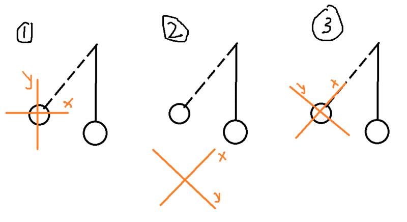

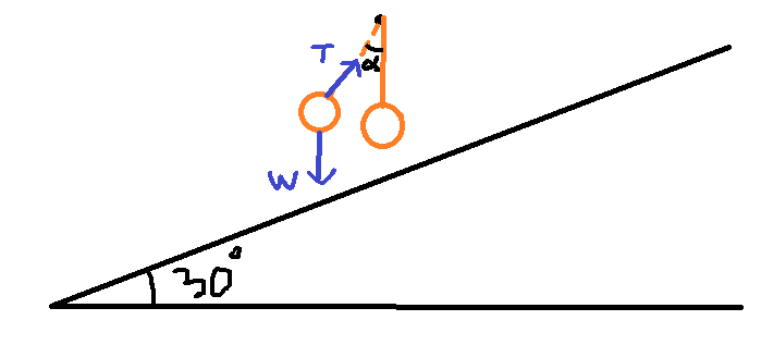

I use g = 9.81 ms-2This imy FBD:
Angle α must be small so the motion of the pendulum can be simple harmonic.
When trying to find apparent gravity of the pendulum, which axis should I use?
The second axis is where the x-axis is parallel to the inclined platform.
I tried to use the third one and ended up with W sin α = m.a (as the restoring force) and get the same period as the case where the platform is stationary (which I don't think making any sense).
songoku said:
Smaller
That narrows down the answers.
songoku said:
Uphill and although I am not sure whether the direction matters (because I still don't know the correct way to solve this problem), my guess is yes, the direction matters (taking the case of pendulum in lift accelerates upwards or downwards).
I think I have difficulty analyzing the FBD.
Have you studies non-inertial refrence frames?
It doesn't make sense.

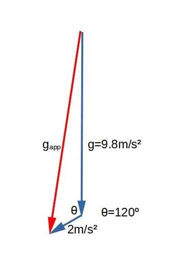

@songoku, here’s one way to tackle these sorts of problems but it may not be the method you are expected to use.
Imagine the pendulum is in your mobile laboratory.
If the laboratory accelerates at 2m/s² (uphill, 30º to horizontal), then inside the lab’ the effects of the acceleration are identical to having a new gravitational field of 2m/s² acting the opposite direction (downhill, 30º to horizontal). (For example, as if a massive alien spacecraft had just materialised.)
The apparent gravitational field in your lab’ is the vector sum of the earth’s field (g=10m/s² vertically downwards) and the new 2m/s² (downhill, 30º to horizontal) field.
So you need to do this vector sum.
If g’ is the magnitude of the vector sum, then you know the new period is ##T’=2\pi \sqrt{\frac{L}{\text{g’}}}##.

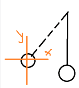

I am using this coordinate system:
Is the vector sum of the acceleration = g + a sin 30o?
If I want to solve this problem using ground's frame of reference, what is the correct approach?
Thanks
That diagram doesn't tell me very much.

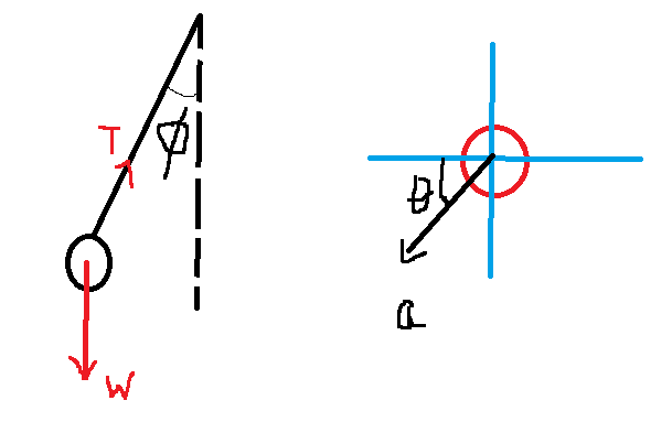

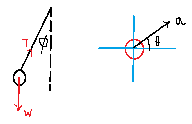

Sorry I am taking the acceleration to be up the incline (to match the original question)
Equation of Newton second law:
(i) T cos ∅ - W = m . a sin θ
(ii) T sin ∅ = m . a cos θ
Is that correct?

If you use the approach described in Post #7 you don’t need any coordinate system!
In the platform’s frame of reference, the magnitude of apparent acceleration due to gravity (##g_{app}##) can be calculated (see Post #7) by simple vector addition (using the cosine rule):
Since the period is inversely proportional to ##\sqrt g##, the new period is: ##\text {old period} \times \sqrt{\frac {g}{g_{app}}}##.
Edit - minor changes for readability.

I want to ask about the coordinate system used. Is there a certain reason to use horizontal - vertical coordinate system (other than maybe it is easier)? Can I use another coordinate system, maybe like the x-axis is parallel to the inclined platform?
Thanks
First of all, the magnitude of the tension ##T## is a scalar quantity and, as such, it is independent of the choice of coordinate axes. That said, the next consideration is choosing a system that makes the algebra simpler.
If one chooses the horizontal-vertical axes (my choice),
  • the tension is ##\vec T=T\sin\phi~\hat x +T\cos\phi~\hat y##
  • the weight is ##\vec W=0~\hat x -mg~\hat y##
  • the acceleration is ##\vec a=a\cos\theta~\hat x +a\sin\theta~\hat y##
If one chooses the parallel-perpendicular-to-incline axes,
  • the tension is ##\vec T=T\sin\varphi~\hat x +T\cos\varphi~\hat y##
  • the weight is ##\vec W=-mg\sin\theta~\hat x -mg\cos\theta~\hat y##
  • the acceleration is ##\vec a=a~\hat x +0~\hat y##
I note that ##\varphi## in the second set of equations is measured from the direction perpendicular to the incline and that is why I used a different symbol. The two sets of equations are comparable and the algebra for finding ##T## is equally difficult. My personal preference is the first set because it references the tip angle of the string to a vertical line which stays the same regardless of the incline angle.
