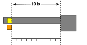

1. We are already clear that Scene#1 takes X seconds.
2. From the computer observer's point-of-view (not another observer standing relative to the cart... but only the computer), in Scene#2, will the computer-observer see the light hit at the same time as in Scene#1? I am sure you would say no. And why? Because the light had to travel an increased distance greater than 7Miles (or M + N).
Therefore we can both agree at the according to the computer observer (only the computer observer), the light from Scene#1 hit at X-seconds while the light from Scene#2 from the computer observer hit at Y-seconds. Two clearly different times. I think this is correct so far right? If i am wrong at this point, then please let me know. There is no point in explaining scene#3 if it is wrong at this point.
3. Now for scene#3 (assuming you agree with the prior 2 scenes).
And again, keeping in mind that we are talking about times from the computer observer's view (not someone relative to the cart).
Which of the options below will the single computer observer (currently traveling away from its rest point just like it did in Scene#2) detect?
A) Both lasers hit at X-seconds
B) Both lasers hit at Y-seconds
C) One laser hit at X-seconds while the other hit at Y-seconds
D) None of the above
To make the answer very simple without much back and forth,
The answer i choose is Option (B). Which one is yours?

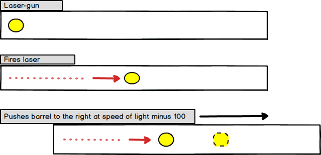

I guess another question that would explain the scenes above would be:
If i had a very long laser-gun with a barrel 30 miles long. And i fired a laser beam.
Now when the light burst is in the middle of the barrel, i push the barrel of the gun in the direction of the fired shot at the speed of light minus about 100 seconds (no nitpicking please.. just trying to understand my foolish question). When i push the barrel, the light particle's position relative to the run's barrel should have been at the dotted yellow circle's point. But instead it will be at a lesser distance.
Is there a computer-observer bolted on the right end of the barrel?
If so, then we are now talking about the question that is same as this: is it possible to delay the hit from a death-ray by starting to move away from the ray.
The answer to that problem is: Yes, the faster you move the the longer you live. Is it possible to delay the hit from a death-ray gun that hangs on you by a rope? Yes, but only the speed that you gained after the firing of the ray counts.

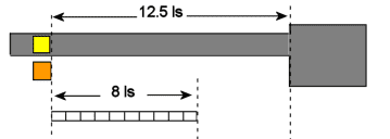

Scene-1: The computer says that the laser's travel takes 5 seconds from the orange rectangle, which is placed 7 miles away by jay t, or by the computer, no difference there.
Scene-2: The computer says that the laser's travel takes 7 seconds from the orange rectangle, which is placed 9 miles away by by jay t.
Scene-3: The computer says that both lasers' travels take 7 seconds from the two rectangles, which are 9 miles away when the lasers are fired.
(the computer has a shortened ruler if it moves, that's why it says the distance is 9 miles)
(numbers are not correct, numbers are for illustrative purposes only)
There's a problem with this scenario. If you push the barrel from the left end, The impulse from that push can't travel through the barrel of the gun at a speed greater than the speed of light. The right end of the barrel won't have even moved before the light pulse reaches it. This is often a tripping point for people first learning Relativity, they assume that they can use objects of perfect rigidity in their examples, but Relativity prohibits the existence of perfectly rigid bodies.
Another thing they sometimes do is to "jump ahead" to scenarios that involve accelerations or sudden changes of velocities before they have fully come to terms with dealing with scenarios with uniform motion alone.

With both lasers firing at time zero, the correct answer is:
If the computer is at rest relative to the cart, both lasers hit at the same time, after five seconds have passed.
If the computer is at rest relative to the ground, both lasers hit at the same time, after a bit more than five seconds have passed (I'll post the exact amount more when I have time, unless someone else reading this thread gets to the calculation first).
If we do this problem with two computers, one on the ground and one on the cart, they will disagree about the time that passed (one will say "five seconds" and the other will say "a bit more than five seconds") and they will both be right.

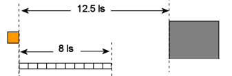

We both agree that scene#1 takes 5 seconds. So from now on, I will not refer to it again.
I will also not mention scene #3 yet, because I do not think you understand what i meant in Scene#2.
So here is scene #2 again. I will not go to scene#3 unless we both agree with scene#2.
In Scene#2, it is exactly like Scene#1 --> BUT, we have this important difference ---> Which is this:
The very exact moment that the laser leaves the stationary laser-gun, the computer then begins to move away from the same stationary laser-gun at speed S. (if the speed S does not matter, then ignore it. The point I am trying to make is that the distance the light has to travel will be different than scene#1).
Since the distance that the light has to travel to hit this computer is longer than the distance it had to travel in scene#1, will the time taken for the laser to hit the computer be the same time taken in scene#1? or will it be greater than the time taken in scene#1?
NB: We are talking from the the perspective of the computer (the only observer). To the computer, will the will the time taken for the laser to hit be greater than scene#1?
Ok, you might have a point here.. But like I said, this second image was only shown to better explain image#1 with the 3 scenes. If using the 2nd image was a bad example, then i apologize.. we can ignore it.
but before i truly give up image#2, will it make a difference in rigidity if I said that the barrel was pulled from the right end instead of being pushed from the left?
In scene 2, the distance the light has to travel to get from laser to computer is more than 930,000 miles for an observer who is at rest relative to the ground. However, it is still exactly 930,000 miles and five seconds for the computer.
One way of seeing this (and I mentioned this in post #27 above) is to consider that as far as the computer is concerned, scene 2 is the exact same problem as if the ground starts moving to the left instead of the cart and computer moving to the right.
From the perspective of the computer, the distance in scene 2 is not longer than in scene 1, so the time is the same: five seconds.
(I don't know if you've noticed this... But when you say that the computer and cart are moving to the right at 4600 mph, you've introduced a second observer who is at rest relative to the ground. That 4600 mph speed is a speed according to that observer - as far as the computer is concerned it is always at rest relative to itself).

This might have been answered in some previous post, but l ask it anyway for clarification:
jay t, in your post no 16, scene 3, which distance is 7 miles? Is it
a) the distance between the laser gun on the truck and the computer, measured in the reference system of the ground, or
b) the distance between the laser gun on the truck and the computer, meusured in the reference system of the truck?
Those distances are different, because of length contraction.
Notice also that I here disregard the laser gun on the ground, which is not needed to answer the question, and it would only complicate things to involve it, since we then must specify times.

  • #53
If i measure the distance (represented by the dotted line) from the front of the laser gun, to the other dotted line (the start of the computer) will this be (a)? or will this be (b) ?
ok I am not a physics guy, so I am not sure which option this would be. I am just literally measuring the distance from the gun to the computer..

  • #55
Are you using rulers at rest with respect to the computer/truck or at rest with respect to the ground? That is all that you are being asked here.
  • #56
Yet, you must choose one of the options, since they give different lengths. Perhaps the question you must ask yourself is:
In which reference system are the dotted lines fixed? Are they fixed relative to the ground or relative to the truck?

  • #58
The dotted line markers are fixed on the ground. The truck is racing down a track toward the lines. As soon as the yellow lasergun lines up with first dotted line (which also lines up with the orange laser gun) they both fire at the same time
