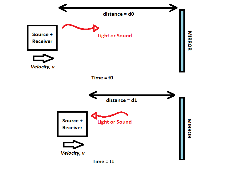

Hi all,I originally posted this question as a reply to another post, but afterwards I thought it would be better to start a new thread. Unfortunately, I couldn't figure out how to delete the old post. With that out of the way...
In the experiment, we send either light or sound from a source, and calculate the speed of the wave as (d1 + d0)/(t1 - t0). My understanding is that for light, the calculated speed will be c regardless of v. However, for sound traveling in a stationary medium such as air, its speed in a stationary frame of reference will be independent of v, but the speed calculated by the receiver, (d1 + d0)/(t1 - t0) depends on v.
Am I going wrong somewhere? Earlier, one of the other members mentioned that the speed of sound is independent of the speed of the receiver, just like light.thanks,

That's right - the speed of sound is simply dependent on the temperature and density of the medium. Once a wave is set up, the speed of propagation of the wave will be independent of the relative velocity of the source.
The speed of propagation of the wave relative to the observer is affected by the observer speed by addition of velocities. However, the relativistic addition formula says that :
$$ \forall v, c\oplus v =c $$
$$ v_1\ll c, v_2 \ll c \Rightarrow v_1\oplus v_2\simeq v_1+v_2 $$
So you get the two different results for light and soundwaves.

This is what I had understood, but according to another member, (post #6 at the following link)
https://www.physicsforums.com/threads/fizeaus-experiment-interpretation.790524/
Also with sound, the speed of neither the source nor the receiver has any influence on its speed until it reaches the receiver
So I would like to confirm that the above statement is incorrect with emphasis on the speed of the receiver. Assuming it is incorrect, my next question is, have there been any experiments to test the speed of light with a moving receiver rather than a moving source?thanks,

I think I agree with that other poster, but actually I am not sure we can make general statements (speed relative to what ? Is there a medium of progagation ? )
I would say that
- the speed of the wave relative to its medium of propagation is constant. This brings an issue for light in vacuum, but it's ok since c is invariant anayway, so light propagates at c wrt the vacuum, whatever velocity we may arbitrarily assign to that vacuum.
- the emitter movement wrt the medium has no impact on that (it does yield a shift in frequency but this is another matter - let's assume for simplicity that the wave velocity is independent of frequency here), but the wave speed relative to the emitter is impacted and can be calculated by addition. Typically, we don't care about it (except for instance for supersonic emitters traveling faster than the wave the emit).
- the receiver has no impact either (though his perceived frequency is affected), except that we may care to inquire about the wave velocity relative to him, which is again obtained by addition.
I think the simplest way to view it is in the medium rest frame, then transform to whatever frame we are interested in.
In the case of light in a vacuum, c survives any addition unharmed, so the result relative to any observer is always c. But in case of light in a physical medium, slowed down to significantly below c, I can't see why the same formulas as for sound waves wouldn't apply.
I would agree that the different unstated assumptions about frame of reference make what look like identical statements actually not.
The speed of light is fixed in the observer's frame, but the speed of sound is fixed in the medium's frame.

Hi PeroK,the whole point of this thread is to understand the difference in propagation between light and sound (for me anyway).
Assume I am an observer in the rest frame and I measure the speed of light from a moving source. I would record the value as 3e8 m/s assuming the medium is a vacuum. Now do the same experiment with sound. Assuming the medium is air, the speed of sound would be 300 m/s. It is likewise unaffected by the speed of the source.
The same is not true if I were to consider a moving receiver and a stationary source in a vacuum for light, and air for sound. In the case of light, the speed would be unaffected by the speed of the receiver, but for sound, the measured speed would be almost a direct addition of velocities of the receiver and the sound. In fact, if the sound receiver were traveling at 300 m/s in the same direction as the sound itself, then the sound wave would never reach the receiver, and the receiver would conclude that the speed of sound is 0. regards,
Aaron
Has it been clarified where those times and distances are measured? For sound it does not matter (for relevant velocities), for light it is important as different reference frames will get different measurements for times and distances.
If you measure them in the system of the mirror, then the speed is independent of the motion of receiver and emitter.
I thought that for light, the speed would be independent of the reference frame...I didn't bother with the actual measurements of time and distance for the light case, as it would over complicate things.

That's because sound travels through an observable medium. So, all observers can measure their absolute speed relative to that medium.
If there were an ether, light would be the same.
It's the absence of an ether that makes light in a vacuum "different".
In a way, you seem to understand this difference fully. If sound could travel through empty space at other than the speed of light, there would be a problem. But it can't, so there isn't!
