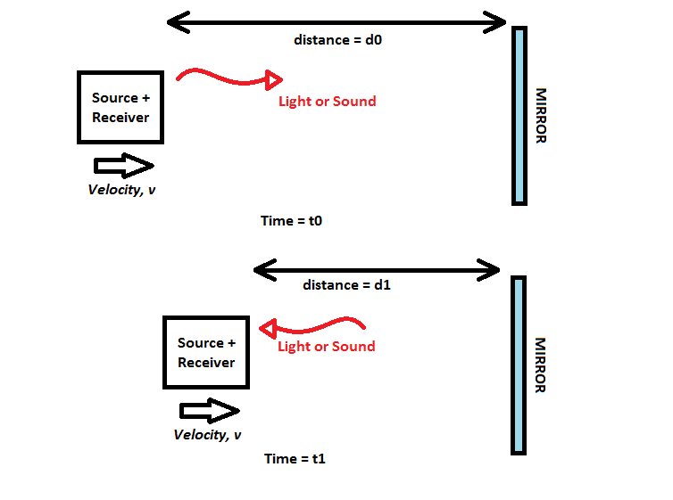

I thought that I had understood your point here, but now I'm not so sure. So I've illustrated my experiment below.
In the experiment, we send either light or sound from a source, and calculate the speed of the wave as (d1 + d0)/(t1 - t0). My understanding is that for light, the calculated speed will be c regardless of v. However, for sound traveling in a stationary medium such as air, its speed in a stationary frame of reference will be independent of v, but the speed calculated by the receiver, (d1 + d0)/(t1 - t0) depends on v.
So where am I going wrong?thanks,
Aaron
P.S anybody is welcome to respond.
Diagram of a source and receiver moving at velocity v toward a mirror, showing a wave travelling to the mirror at time t0 with distance d0, and returning at time t1 with distance d1.
