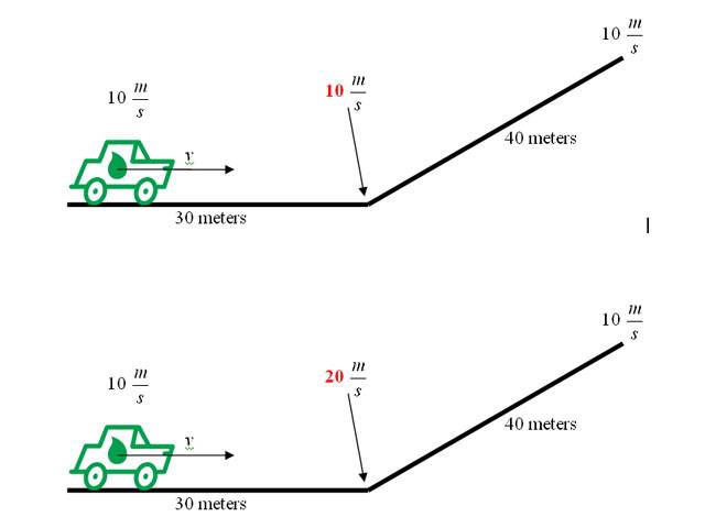

Is there any way to prove that speeding up before a hill in a car will save you gas compared to maintaining your speed on the hill?
Here is the situation:
Notice, the one car maintains 10m/s throughout while the second car accelerates to 20m/s on the flat part. Both cars will have the same potential and kinetic energy at the end.
My original approach was to convert MPG of my car (35 mi/gal) to J/m (aka Netwons) by using the conversion factor of 34.8 x 10^6 J/L, which I did and got 2338.95 Netwons of force. Since MPG is presumably measured on a flat surface with a constant speed, that means my car requires 2338.95 Netwons of force to maintain speed so the force of friction is also 2338.95 N. Therefore, since I had the force of friction total of the internal parts of my car, I thought the rest of the problem would be easy. However, when I did all the math, the result showed that the energy required was the same, but that goes against the saying that you should speed up before hills--is that unfounded?
Thanks for any help and if you need any clarification, I'd be willing to explain anything. This really interests me so I'd love to know what you guys think.
-Paul
Although it's fairly insignificant, if you wait until you are on the hill to accelerate (simply maintaining speed on the hill) gravity will be pulling down on the gas you would've burned speeding up before hand, resulting in a greater gravitational force and more energy lost from the system.
Well, even though I am not accounting for drag, the higher speed of the second car would make it have to work harder so things like the amount of gas in the tank are not significant either. Although it's the little things about physics, isn't it?
the raw physical energy needed to climb the hill is the same whether you speed up or not.

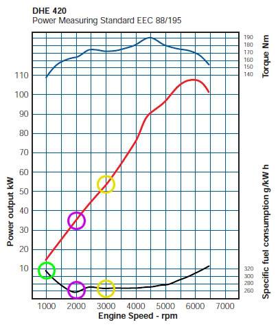

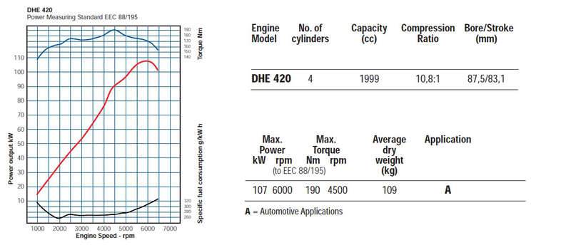

Some digging gave me something:

One number that people don't often quote is the fuel consumed by the vehicle at idle.
This plays a big part in the fuel efficiency of a vehicle at slow speeds.
My guess is that you should speed up to the optimal mpg based velocity of the vehicle and maintain that speed up the hill.
Well, my idle fuel consumption is the green circle since my car basically idles at 1000 rpm.
Does that mean idling, it is just as efficient as it is at 6000rpm (aka, not really that efficient?)
At 2000rpm, that's my prime efficiency, correct?

The curve at the bottom serves for efficiency. At 1950 rmp, or so, the engine puts out the most power per gallon of fuel.
To turn rpm into miles per hour, you need to know about the transmission and the rest of the drive train.
Couldn't you turn the KwH or the Joules into Kinetic Energy without it? (1/2 mv^2)?
That's at full throttle. The graph would need a 3rd dimension to include the efficiency versus rpm versus throttle position. Then you'd need to compare the efficicency versus power for the power required for speed and rate of climb.
