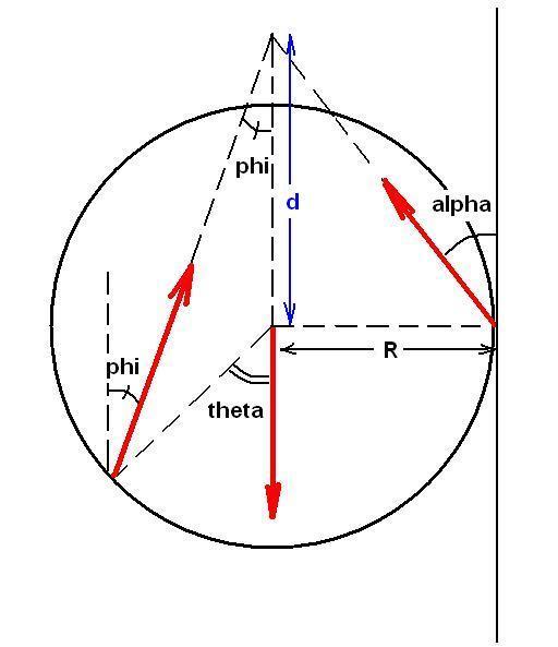

Sorry, I was wrong earlier. This problem is tougher than I thought. At this time, I haven't arrived at the exact answer yet. Anyway just some thoughts:

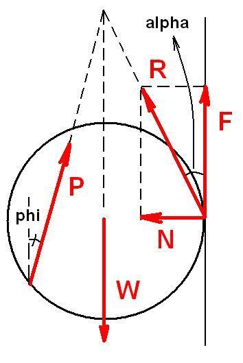

[tex]\vec{R} = \vec{F} + \vec{N}[/tex] is the sum of frictional force and normal force, i.e. it is the force exerted by the wall. The torque balance condition leads to that [tex]\vec{P}[/tex] , [tex]\vec{W}[/tex] and [tex]\vec{R}[/tex] must be concurrent.
From the force balance condition:
[tex]Pcos\phi + F = W[/tex]
[tex]Psin\phi = N[/tex]
We also have: [tex]F\leq \mu N[/tex]
Therefore: [tex]P \geq \frac{W}{\mu sin\phi + cos\phi}[/tex]
Since [tex]\mu = const[/tex] , after doing some math, we arrive at:
[tex]P \geq \frac{W}{\mu sin\phi + cos\phi} \geq \frac{W}{\sqrt{1+\mu^2}}[/tex] .

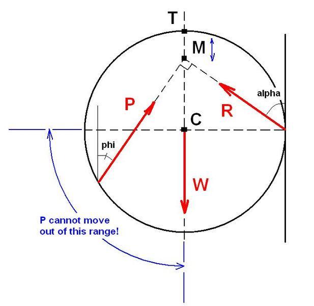

So with that assumption, we have: [tex]P=P_{min}=W/\sqrt{1+\mu^2}[/tex] when [tex]tan\phi = \mu[/tex] and friction is maximum (F=uN). When friction is max, [tex]cot\alpha = \mu[/tex] and thus [tex]tan\phi = cot\alpha[/tex] . With this relation between 2 angles, plus the concurrency condition found earlier, we can see that [tex]\vec{P}[/tex] is perpendicular to [tex]\vec{R}[/tex] (not reflection!) - See picture 1.
Now here comes the trouble: As [tex]\vec{P}[/tex] must be exerted on the lower leftmost quarter of the sphere, and [tex]\vec{P}[/tex] is perpendicular to [tex]\vec{R}[/tex] , we can see that the point of concurrency M can only move in the range from C, center of the sphere, to T, top point of the sphere. That corresponds to a range of value of [tex]\alpha[/tex] and thus [tex]\mu[/tex] , as [tex]\mu = cot\alpha[/tex]: [tex]45^o \leq \alpha \leq 90^o[/tex] and [tex]0 \leq \mu \leq 1[/tex]. That means, the result we've got can only apply to cases where [tex]0 \leq \mu \leq 1[/tex]!
In practice, normally, [tex]0< \mu < 1[/tex]. However the case [tex]\mu > 1[/tex] does exist. And this is where I'm completely stumped. If we return back to the first few equations, we can see that these will hold for any cases (as long as there is equilibrium):
(1) [tex]P \geq \frac{W}{\mu sin\phi + cos\phi} \geq \frac{W}{\sqrt{1+\mu^2}}[/tex]
(2) [tex]cot\alpha \leq \mu[/tex]
The concurrency condition leads to another equation - see picture 2:
[tex]R = dtan\alpha[/tex]
[tex]\frac{sin(\theta - \phi)}{d} = \frac{sin\phi}{R}[/tex]
Thus: (3) [tex]sin(\theta - \phi)tan\alpha = sin\phi[/tex]
And a restriction of the position of [tex]\vec{P}[/tex]: (4) [tex]0^o \leq \theta \leq 90^o[/tex]
Now you have a bunch of equations + inequalities. Solving them is not an easy task. Wanna try? :biggrin:

Suppose that [tex]\vec{W}[/tex] meets [tex]\vec{R}[/tex] at point A. Therefore, their torques about this point are zero. The torque about A of the only force left, [tex]\vec{P}[/tex], must also be zero, i.e. [tex]\vec{P}[/tex] also has to pass through A. Therefore, the 3 vectors are concurrent.
Notice that this only applies to a system of 3 forces. If there is another 4th force [tex]\vec{Q}[/tex], then that sum of torques about A of [tex]\vec{P}[/tex] and [tex]\vec{Q}[/tex] is zero doesn't result in that torque about A of [tex]\vec{P}[/tex] alone is zero.
Even if we don't use the concurrency condition, we get
and using slopes of both the lines we find that they are perpendicular.
What I meant is that the result should be that they are perpendicular, not reflection.
The concurrency condition, plus the fact that [tex]\vec{P}[/tex] and [tex]\vec{R}[/tex] are perpendicular to each other, leads to that the intersection point M of [tex]\vec{P}[/tex] and [tex]\vec{R}[/tex] must lie on the vertical line joining C and T (so that [tex]\vec{W}[/tex] also goes through M).
