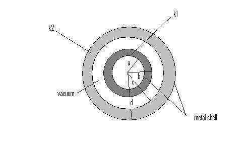

A spherical capacitor is made of two insulating spherical shells with different dielectric strengths, k1 and k2, situated between two spherical metallic shells and separated by a vacuum gap. Calculate the capacitance of this system.
Total C = Q(free) / [tex]\Delta[/tex]V where [tex]\Lambda[/tex]V is the varied potential between the two metal shells.
[tex]\Lambda[/tex]V = [tex]\int^{a}_{d}[/tex]E(r)dr = - [tex]\int^{a}_{b}[/tex][(1/4*pi*Eps) * (1/k1)*(Qfree / r^2) * dr] - [tex]\int^{b}_{c}[/tex][(1/4*pi*Eps) * (Qfree / r^2) * dr] - [tex]\int^{c}_{d}[/tex][(1/4*pi*Eps) * (1/k2) * (Qfree / r^2) * dr]
Q free will be negated in the final equation, since C = Q/V and V includes Q in its numerator (hope that makes sense). So after integrating V through each of the mediums, the two dielectrics and the vacuum, I get the sum :
Ctotal = = Ke[C(dielectric 1) + C(vacuum) + C(dielectric 2) = Ke[(1/k1)*(1/a - 1/b) + (1/b - 1/c) + (1/k2)*(1/c - 1/d)]
Is this correct?

above looks good.
Is this correct?
how did you get this part? stick to what you were doing above... get delta V... then take Q/delta V... don't take any shortcuts...
I did this next...
delV = - (Qfree/(4*pi*Eps)) [ [tex]\int^{a}_{b}[/tex] (dr/(k1*r^2)) + [tex]\int^{b}_{c}[/tex] (dr/r^2) + [tex]\int^{c}_{d}[/tex] (dr/(k2*r^2))
The general form of the solution for int(dr/r^2) is -(1/r). This let's the pre-existing negative cancel out, and I just have to substitute to get the expression I have above... I've got it written down, just didn't want to type it all out. :)
Also, the solution I came up with should be equal to 1/Ctot, not just Ctot. I think that's right...

Yes, exactly that was 1/Ctot. everything looks good.
