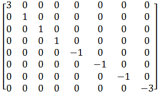

There is a problem though:
If I add together the three spin matrices (z-direction) for 3 spin 1/2 particles, I get:

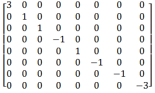

But surely it should be:
It doesn't really matter as long as you remember, which eigenvector (when you have to calculate it) belongs to which eigenvalue. For example the eigenvector ##(0,0,0,1,0,0,0,0)^T## belongs to eigenvalue ##-\hbar## in the upper matrix, but belongs to ##\hbar## in the lower one.
