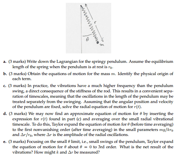

Please see attached image :)
Euler-Lagrange Equation
[itex]\frac{\partial{L}}{\partial{q}} - \frac{d}{dt}\frac{\partial{L}}{\partial{\dot{q}}} = 0[/itex]
[itex]L = T - V[/itex]
a. The potential energy V is the potential energy from the spring and the gravitational potential energy. The kinetic energy is the energy in the radial direction and in the theta direction.
[tex]L = \frac{1}{2}m(\dot{r}^2+\dot{\theta}^2(r_0+r)^2) + mg(r_0+r)cos\theta - \frac{1}{2}kr^2[/tex]
b. Use one Euler-Lagrange equation for r and one for theta and I get: [tex]m\dot{\theta}^2 + mgcos\theta - kr = \frac{d}{dt}(m\dot{r})[/tex] [tex]-mg(r_0+r)sin\theta = \frac{d}{dt}(m\dot{\theta}(r_0+r)^2)[/tex]
Which are the F=ma equation for the radial direction and the Torque = (d/dt) Angular momentum equation.
c. Confused here, if angular position and velocity are to be fixed, I assume they mean [itex]\theta[/itex] and [itex]\dot{\theta}[/itex], do I consider them both to be zero, or just a constant number? And if the position is fixed doesn't that mean that the velocity should be zero? Is this a differential equation I have to solve?
d. and e. Need c to continue.
Any help is appreciated, thanks !

"Fixed" means "constant." The position and velocity aren't actually fixed (so ##\dot{\theta} \ne 0##), but because the timescale over which the radial motion occurs is so short, you can analyze the motion as if ##\theta## and ##\dot{\theta}## were constant. It's an approximation.
By the way, the first term in the radial differential equation is incorrect.
Thanks I must have missed a (r_0 + r) factor in the first term when I was putting it into tex, I'll give it a shot with theta and theta dot as constants.
