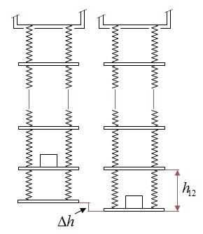

[/B] In a tower a princess throws a ladder of 20 plates of thickness d and mass m each, which are connected with springs of constant k and loose length l0. the window is at height H.
1) What's the elongation of each of the spring pairs?
2) What's the total ladder's length.
3) The princess's lover, mass M, climbs to the first step and waits to the oscillations to stop. what is the ladder's length now.
4) The lover now climbs to the second step and waits. what's the length now.
5) When he passes from step 1 to 2, what's the change in the system's mechanic energy?
6) When he sits on the n-th step, what's the ladder's length?
7) If he would climb up slowly to the window, what would be the length of his way?

1) The elongation of each of the n-th pair of strings: ##nmg=\overline k\cdot \Delta x_n~\rightarrow~\Delta x_n=\frac{nmg}{2k}##
2) The total length of n stages of the ladder, starting from the bottom:
$$L_n=n(l_0+d)+\sum \Delta x_n=n(l_0+d)+\frac{mg}{2k}\sum n=n\left[ l_0+d+\frac{mg(n+1)}{4k}\right]$$

5) When M climbs to the second step the total energy of the ladder and M system increases by Mg x (difference of height between the steps). the first step rises a bit as M leaves it but it's energy gain is balanced by the energy loss of the spring's contraction.
$$h_{12}=L_{20+M}-L_{19+M}=20\left[ l_0+d+\frac{21mg}{4k} \right]+\frac{20Mg}{2k}-19\left[ l_0+d+\frac{5mg}{k} \right]-\frac{19Mg}{2k}=l_0+d+\left( 10m+\frac{M}{2} \right)\frac{g}{k}$$
$$\Delta h=\frac{Mg}{2k}$$

The princess throws the ladder from the top. She does not hold any plate. As the diagram shows, the highest plate is one spring length below the window.

What's the height's energy gain by the rising of the step as M leaves:
The difference in height as M leaves is:
$$\Delta h=\frac{Mg}{2k},~~\Delta E_m=mg\cdot \Delta h=\frac{Mmg^2}{2k}$$
As M leaves the system gains more energy than than it looses by the contraction of the springs:
$$\Delta E=Mg\cdot h_{12}+\Delta E_m-\Delta E_{spring}$$
$$\Delta E=Mg\left[ l_0+d+\left( 10m+\frac{M}{2} \right) \frac{g}{k} \right]+\frac{Mmg^2}{2k}-\frac{Mg^2}{4k}(M+2m)>0$$

Karol said:
How can it be?
What puzzles you? There is some cancellation available in your last two terms above. That done, you see the increase in the energy of the system is the prince's gain in PE less a bit for the relaxation and rise of the bottom link. This comes from the work done by the prince in stepping up.
